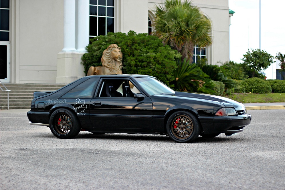

Josh@Ridetech 01-19-2017 01:10 PM
2 Attachment(s)
Originally Posted by Merritt5 (Post 652769)
I guess there isn't many die hard Ford guys on here, ha!
Hey now... I'm here :thumbsup:
Attachment 60933
Attachment 60932

Merritt5 01-23-2017 08:36 AM
Your car looks sharp.
You still have the McPherson front suspension?

Josh@Ridetech 01-24-2017 05:23 AM
Thanks! and I do. I'm running our HQ coilovers front and rear.
