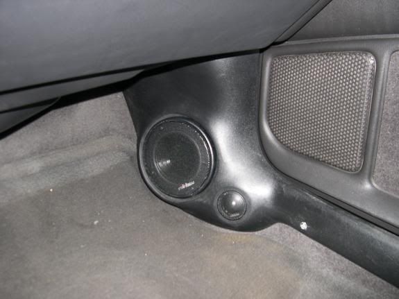

i did this in a newer camaro, but id like to try an older car.....
http://i39.photobucket.com/albums/e1...arosskicks.jpg

Hard to see in the pic, but we custom mounted some speakers in my kick panels. But like Frank said the stock e-brake will get in the way.
http://s34.photobucket.com/albums/d1...gAnch=imgAnch8
