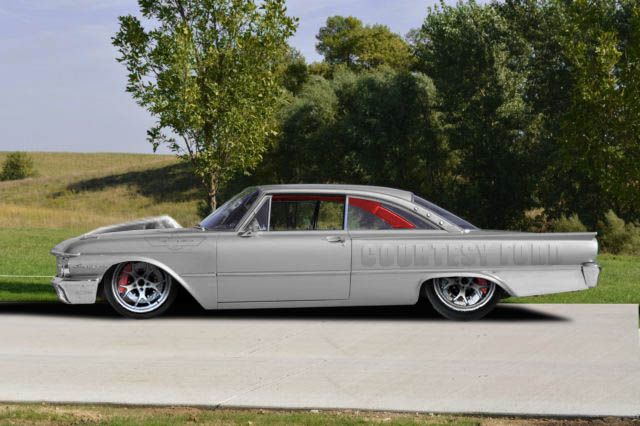

StarlinerJack 06-09-2017 12:52 PM
Got my rendering
Well I know all of you patina guys will be disappointed but I think you'll appreciate where im going with the car. Here's the rendering my son made for me
https://picload.org/image/rwdgopdl/1...arliner-tw.jpg
526hp8o 06-09-2017 02:16 PM
I like it. We are doing the same hood on ours, I'm told its about 3 months wait on the hood
preston 06-12-2017 09:27 AM
That looks bad ass ! Hope you can replicate that stance !
http://i1339.photobucket.com/albums/...psajqptloh.jpg
So killer. Great project. :thumbsup:

This is the coolest thing I've seen in a very long time. And the rendering is so badass. As an FE guy, I'm glad to see thats the route you want to go. I got the teardrop hood for my '64 from crites and it was a 6-8 week wait if I remember correctly.
