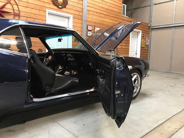

Hi everyone - I've spent quite a bit of time over the years following the awesome build threads on Lateral-G. Now, I can hopefully contribute a little bit. I'm a rookie build thread writer so please bear with me!
I've owned this 1968 Camaro for 27 years. When I first bought it, we did a very low budget build to get it on the road. Drove it like that for 10 years, and then had finally saved enough money to repair all of the rust and do proper body work. Well, the car had way more rust than anticipated and I spent considerably more to get there body back in shape than I had wanted to spend, but I wanted it done right. Unfortunately, that meant that I had to make sacrifices on the performance side of things.
Finally, after it looking pretty for 17 years but not really being that fun to drive I get to Step up the performance a bit!!
I've decided to completly rework the suspension and drivetrain as follows:

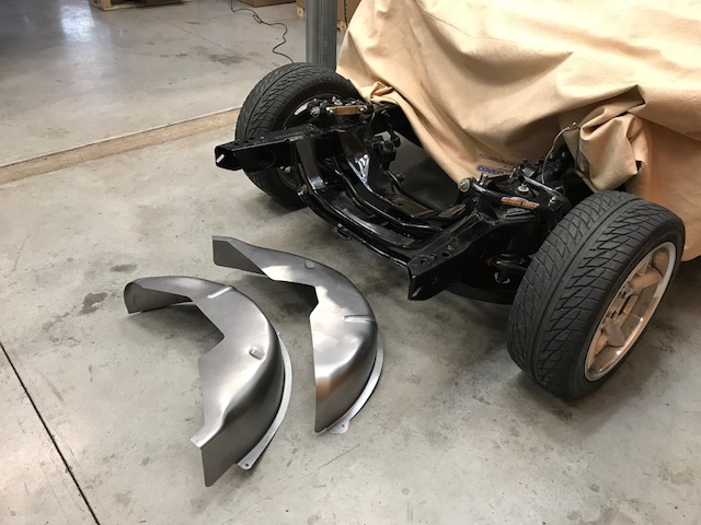

complete Speed tech Extreme sub frame kit
Speed tech Torque arm rear suspension
Full floating 9" rear axle
GM performance parts LT4 crate motor
T56 manual transmission
Stainless steel headers for LT4
Stainless steel Ricks vapor works fuel tank
DSE mini tubs and speed tech fiberglass inner wells in front.
Forge line RBC3 wheels
Vintage air HVAC system
PRC radiator
Stop tech 6 piston 14" rotors all around
Ron Sutton valved coil overs with Draco springs
Here's how she started the day

By this evening I had the interior out and all the fluids drained.
Attachment 64005
My plan is to get everything dismantled this week before having to head back to work next week. Tons of parts are showing up to the house daily, and the engine/transmission is being delivered Thursday!

next on the agenda is to tackle the DSE mini tubs and the Speedtech firewall smooth kit. I have the tubs, so that'll be first.
I'll be taking a road trip to Utah as soon as the Speedtech parts are built to pick them all up. I'm excited to meet Ben and Roger and see their shop.

Hey guys - I had a chance to work on the DSE mini tubs today. It's a slow go for a guy with no sheetmetal experience but I'm learning...
I got the drivers side factory tub removed and everything cut out in preparation for the new tub. One suprise I found was a ton of sand in the rocker from when I had the car sandblasted 17 years ago. Not sure I'll every have a car sandblasted again after seeing that. Also got ride of an old shock cross member that was installed back in the day that won't be needed any longer. Oh yeah, I also learned that 17 year old Dyna mat is a royal PITA to remove!
