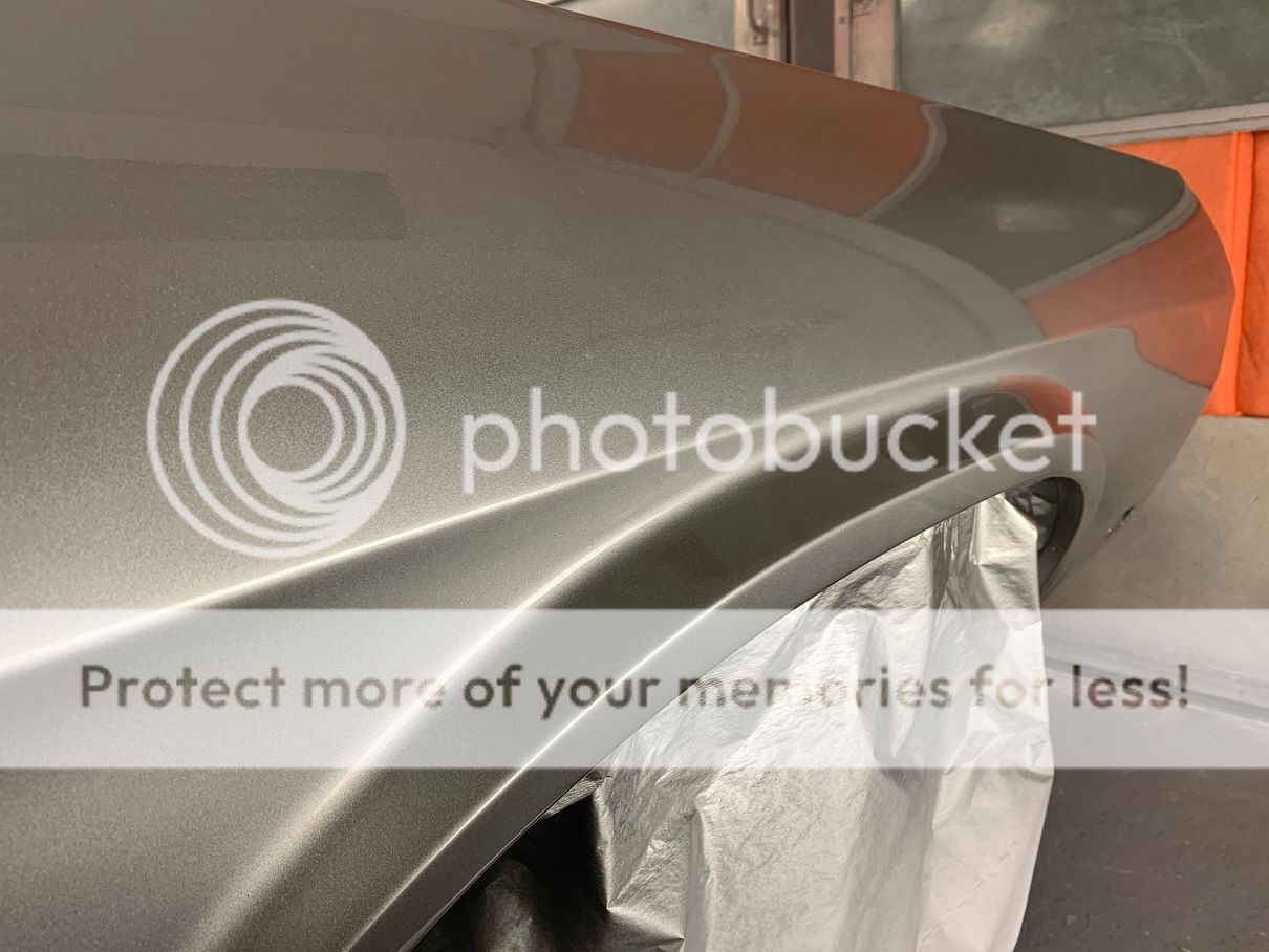

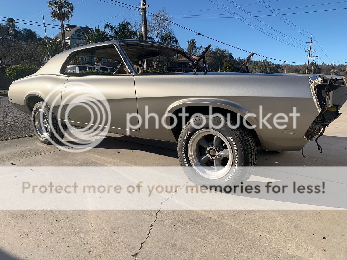

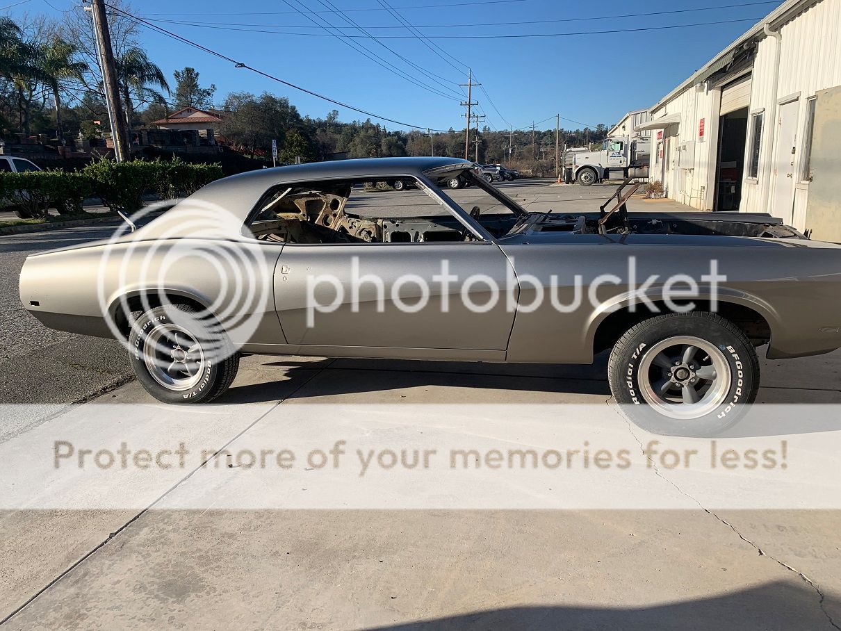

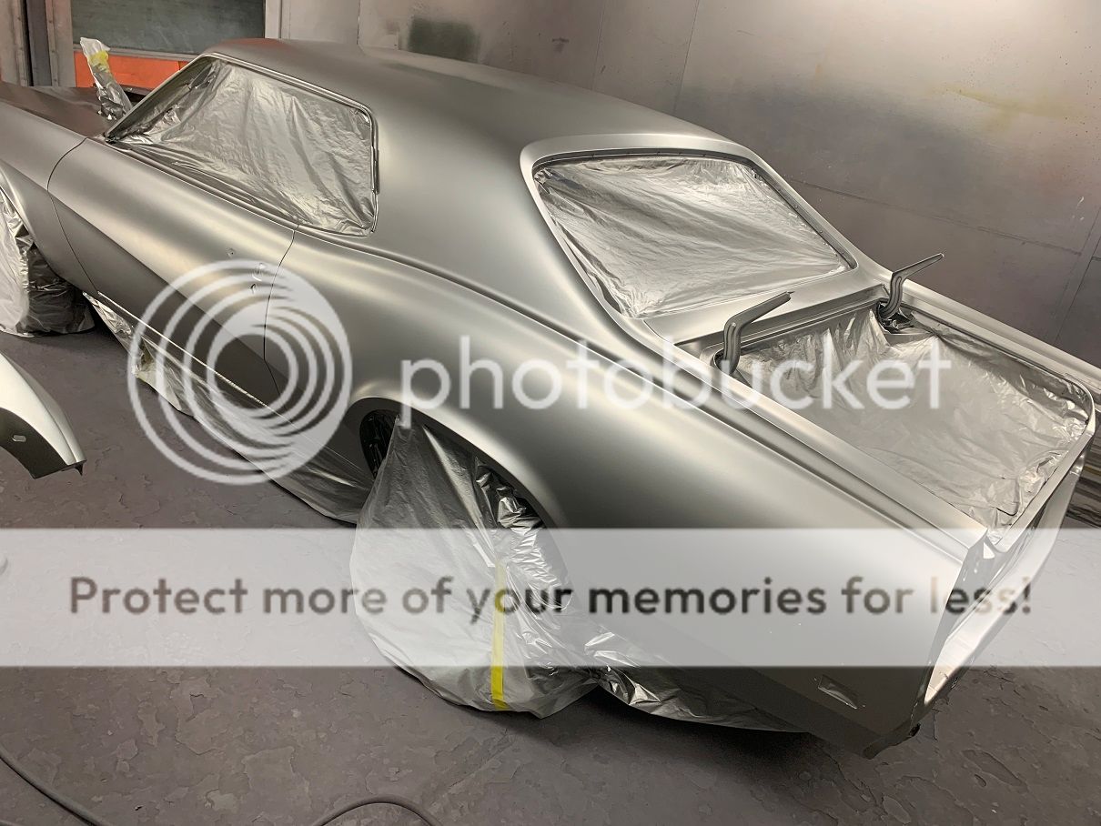

Update! The car's out of the booth and gleaming in the sun. We ended up going away from the orange and choosing something more sultry. This is Lexus 1J7 Atomic Silver. We chose this color to better accentuate the body lines and curves down the doors.The fenders will come off now so we can refinish the engine bay and start reassembly. We'll also start to cut and rub the car after it fully hardens. We like to open the clear up with 1500 to let it fully gas out, then begin the whole polishing process. More to come!

Looks awesome Dave!
WSSix 02-12-2020 06:32 PM
Beautiful silver! Congrats on getting the car in color.
NOPANTS68 02-13-2020 08:39 AM
Thanks guys. Trying to figure out a wheel/tire combo. The 15s are my shop rollers.
