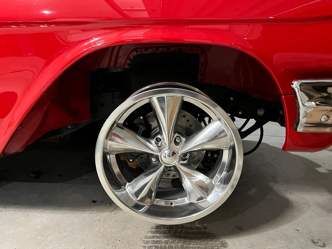

Cramer4918 06-15-2022 06:26 PM
The last of my wheels finally came in. I will be running polished Boyd Coddington Junkyard Dogs. 20X9 Rear and 18X8 Front. I did notice a few things after looking at these pics...
1- I need to sweep my porch
2- I definitely need to drop the front more
3- The center caps don’t match 🤦🏻
Seems like the way things are nowadays. Oh well. I’ll see if I can get a matching set. Wish me luck!
Until then, I’ll leave these here…
