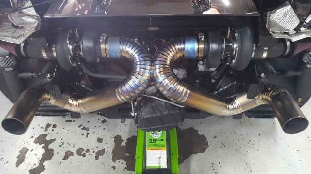

mfain 03-15-2023 05:45 PM
1 Attachment(s)
Originally Posted by Sheck44 (Post 722209)
Not sure if everyone is up to speed on their TIG welding titanium knowledge, but if not here is what you need to know
It's difficult !! LOL
Both the outside and the inside of the weld must be purged with gas to do it properly
My son would agree. He gets lots of practice since they don't make 4" mandrel bends of the proper radius - lots of pie cuts and each weld is one foot in length.
You have a great project going!
Pappy
Attachment 79961
Sheck44 03-16-2023 04:39 AM
Originally Posted by raustinss (Post 722234)
Been waiting for this one to appear lol. the mods look killer already Steve. ps
yes welding titanium properly is quite tricky . It needs TONS of gas flow of and back purging ,also you need to be careful as titanium can and will become brittle ...its temp sensitive
Thanks Mfain !! Looks great
Ryan, thanks brother ...
So before attempting this titanium build I kept hearing 'oh no don't do titanium it's going to crack !!
YES... it will IF (Ryan I think you'll agree with these)
You use thin walled titanium (we used Titon, one of, if not the best)
It's not welded properly ... Matt is one of the best around
The exhaust is not supported properly ... LOT of consideration went into this, with custom water-jet cut support brackets
We should be good !!

And something really cool I learned yesterday, the 'longer' the joint/bridge in the X-pipe the higher pitched the sound
This system 'should' sound insane ... stay tuned
https://live.staticflickr.com/65535/...768b08b_4k.jpgIMG_1569 by Steve Heck, on Flickr

Sideways X-pipe
1 Attachment(s)
Titanium is WAY sexier than SS but glad to see others doing "sideways" X-pipes on their cars! Can't wait to see and hear the finished result!
But now I'm looking at Granatelli exhaust cutouts for my car... I blame you! Haha
Do your valves bypass the mufflers and the X-pipe or just the mufflers?

There are a LOT of wives out there that disapprove of me as I assist their husbands (friends) in building their car or 'selecting' a new car
Ty, no my valves bypass the buffers when open AFTER the X-pipe ... so headers through race cats to X-pipe and then straight down and through the outside tips
