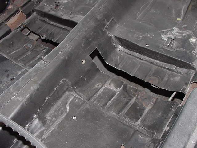

Rick Dorion 12-01-2006 06:18 AM
I did this with an S&W cross member
http://i88.photobucket.com/albums/k1...KgnHotrod5.jpg
http://i88.photobucket.com/albums/k1...KgnHotrod8.jpg
