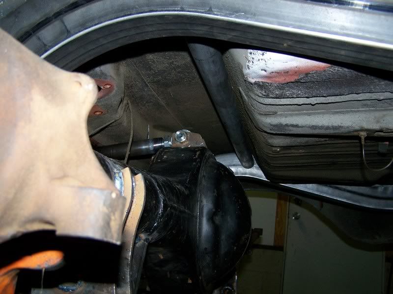

I started to make the support for the bell crank bracket tonight.
http://i41.photobucket.com/albums/e2...r/101_0513.jpg
cross member moched up prior to the bracket
http://i41.photobucket.com/albums/e2...r/101_0512.jpg
:_paranoid Do you guys think the bungee cords are strong enough? :lol:
http://i41.photobucket.com/albums/e2...r/101_0518.jpg

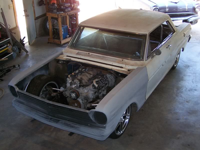

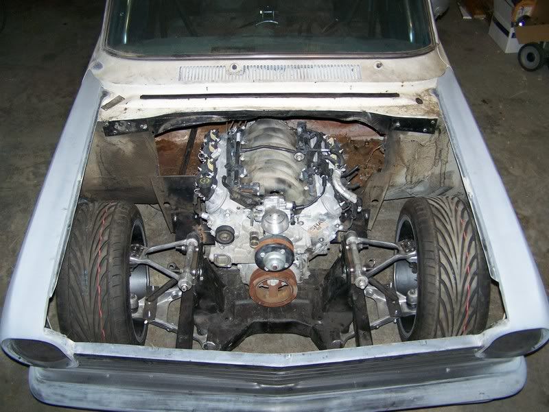

slow4dr 06-25-2007 09:03 PM
I got the motor mounts finished up a few weeks back.
http://i41.photobucket.com/albums/e2...r/100_0808.jpg
http://i41.photobucket.com/albums/e2...r/100_0809.jpg
http://i41.photobucket.com/albums/e2...r/100_0804.jpg
Slowly but surely it's coming together.
http://i41.photobucket.com/albums/e2...r/100_0812.jpg
http://i41.photobucket.com/albums/e2...r/100_0811.jpg

71Nova 06-26-2007 12:10 AM
That is looking great!!
black2002ls 06-26-2007 02:43 AM
looks great. are those C6 Z06 wheels?
Steve Chryssos 06-26-2007 04:46 AM
Looks great. I'm really enjoying all of these hardcore duece's!! :yes:
They are a replica of the C6Z wheels made by a company called ACE and the wheel name is "slick". http://www.acealloywheel.com/
p_call 06-26-2007 10:25 AM
Awesome! I love those engine mounts. They look really great.

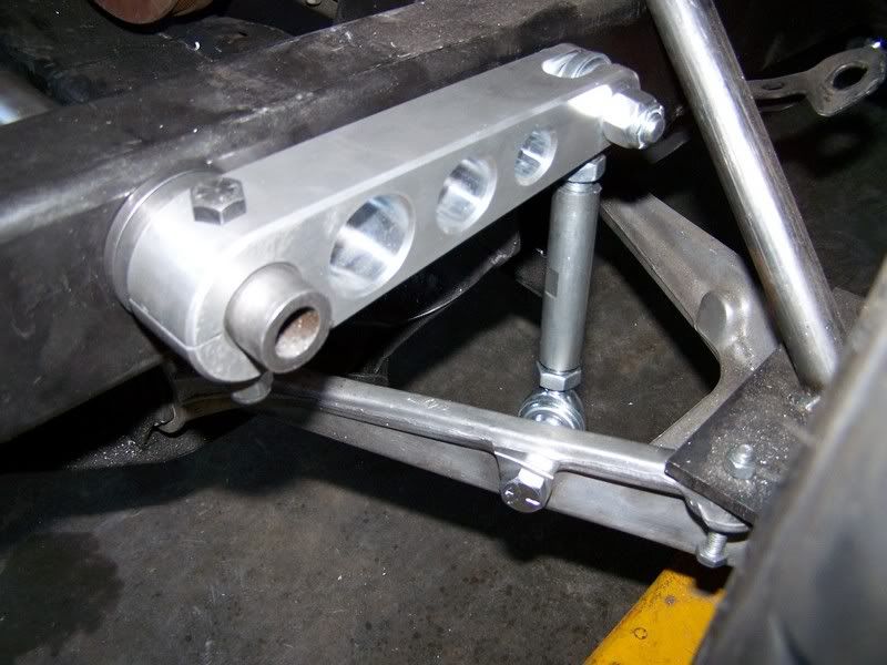

slow4dr 07-05-2007 03:20 PM

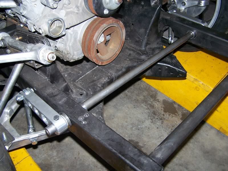

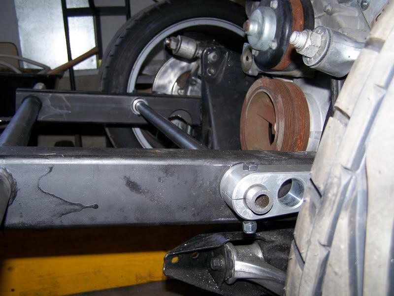

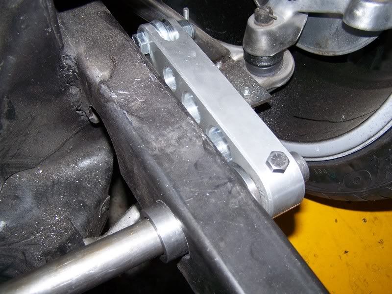

mounting the Competition Engineering sway bar
http://i41.photobucket.com/albums/e2...r/101_0845.jpg
http://i41.photobucket.com/albums/e2...r/101_0844.jpg
http://i41.photobucket.com/albums/e2...r/101_0843.jpg
http://i41.photobucket.com/albums/e2...r/101_0841.jpg

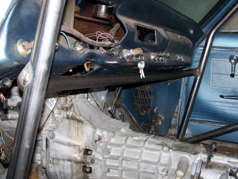

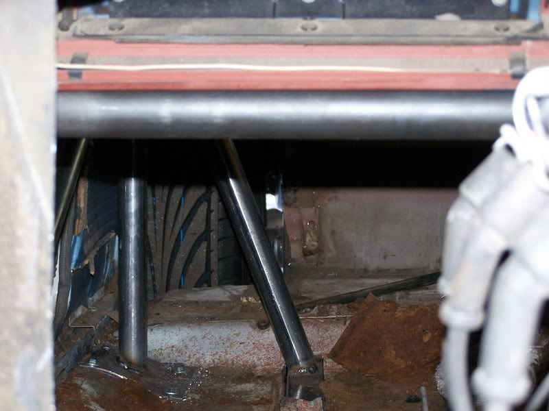

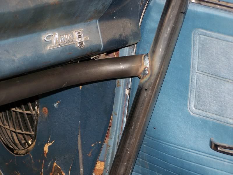

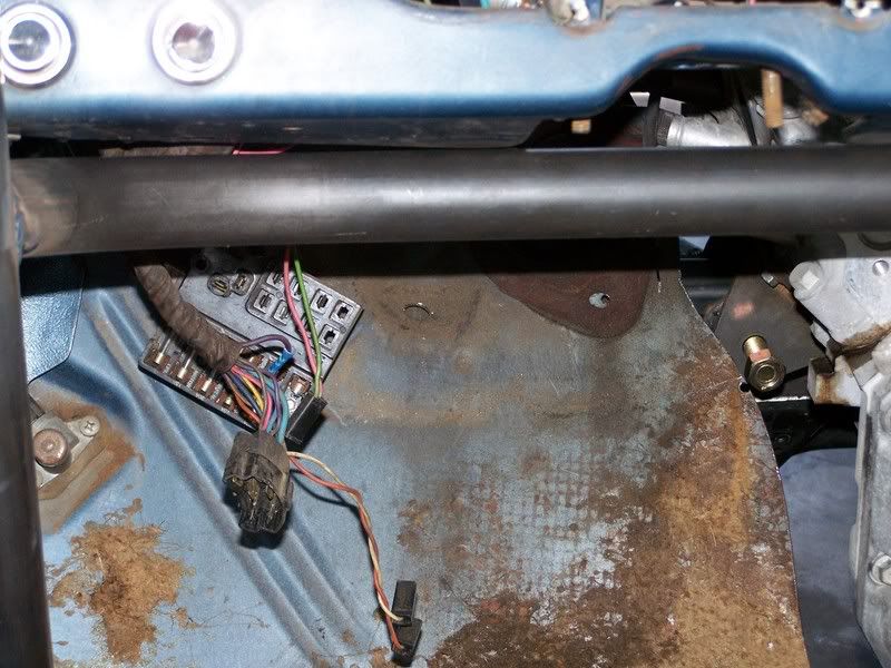

I added this under dash bar to drop the steering column angle and to tighten up the chassis a little more.
http://i41.photobucket.com/albums/e2...r/101_0846.jpg
http://i41.photobucket.com/albums/e2...r/101_0847.jpg
http://i41.photobucket.com/albums/e2...r/101_0848.jpg
http://i41.photobucket.com/albums/e2...r/101_0850.jpg
View from the other side
http://i41.photobucket.com/albums/e2...r/101_0849.jpg
slow4dr 07-05-2007 03:21 PM

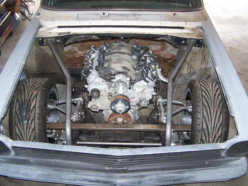

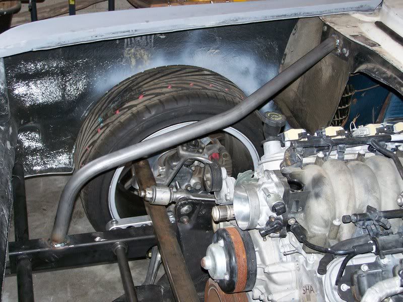

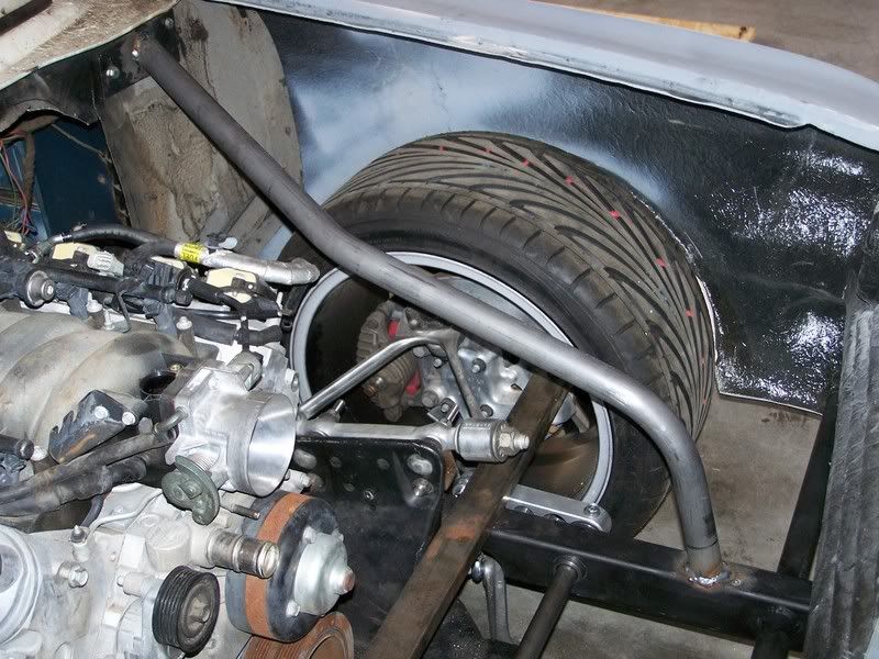

I finally added the down bars as well. Pay no attention to the temporary steering arm.
http://i41.photobucket.com/albums/e2...r/101_0851.jpg
http://i41.photobucket.com/albums/e2...r/101_0852.jpg
http://i41.photobucket.com/albums/e2...r/101_0853.jpg
http://i41.photobucket.com/albums/e2...r/101_0855.jpg
novanutcase 07-05-2007 06:30 PM
Ya must've measured twice.........

How did you go about getting just the Watt's link setup from Fays2? I want exactly what you have but couldn't find it on the site.
BTW, cool build :thumbsup:
slow4dr 07-08-2007 06:30 AM
Thanks! I gave Jim a call and he worked out a great deal on just the parts I needed. He even made custom length arms for me. :thumbsup:

I love the bends on the down tubes and the sway bar looks like it was made to go in there. Great looking work!

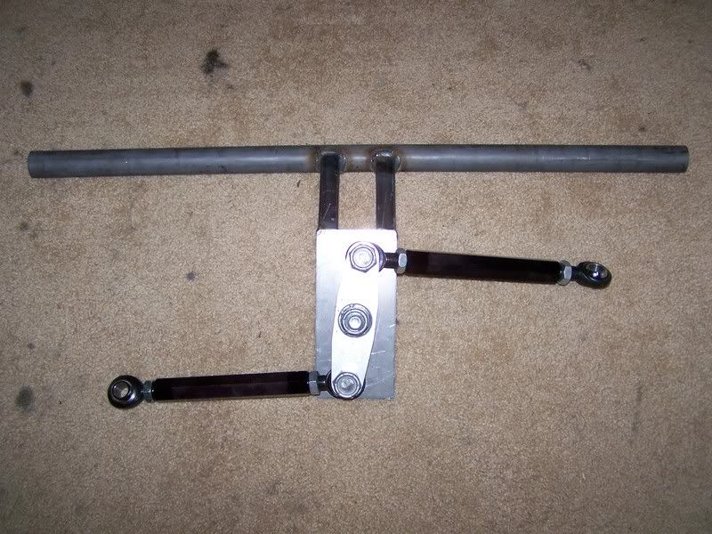

I have been brainstorming on how to run a shock tower brace. I really like John's but I think I will stick with something tubular. I am hoping to make a cross over tube and tie in the shock mounts to the downtubes.
I am thinking about making something like this for the cross over I am just unsure on how to connect it to the down tubes without butchering it.
http://www.granatellimotorsports.com...507-Dsmall.jpg
race-rodz 07-09-2007 09:01 PM
how about some of those bolt in door bar clevis parts.... nice/clean/removable
slow4dr 07-09-2007 09:18 PM
:woot: That's a GREAT idea. :thumbsup: Now I just need to mount the alternator and begin planning it out.

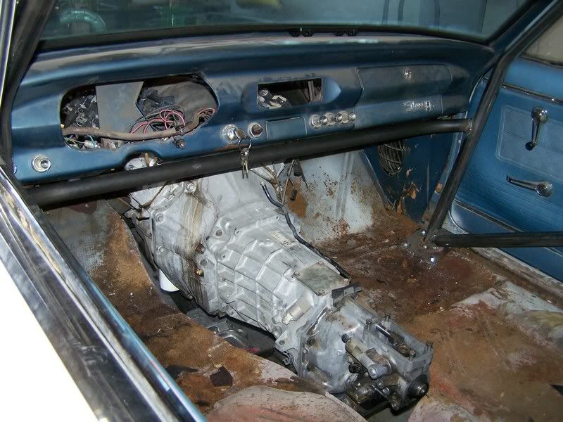

slow4dr 07-10-2007 09:23 AM

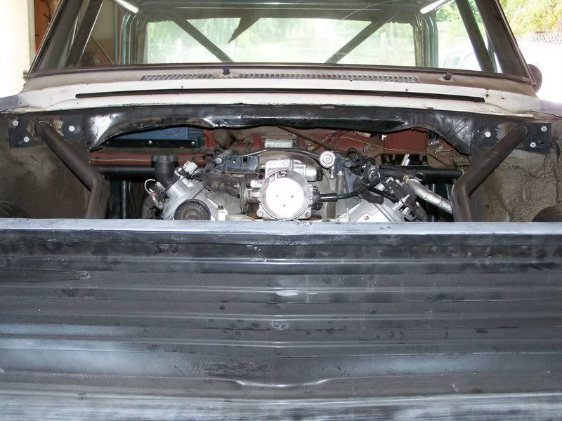

I finally got the tranny cross member finished. It tucks up about 2" higher than the glide member that was in it.
Here is the rearview, the angle is misleading but the bottom of the new cross member and tranny case is almost perfectly even with the height of the body line.
http://i41.photobucket.com/albums/e2...r/101_0884.jpg
From the side you can see the stock member hanging below the body but the new one is out of sight.
http://i41.photobucket.com/albums/e2...r/101_0879.jpg
