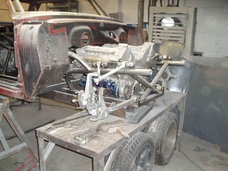

I took the car to the fabricator on Dec 17, but we just got the motor mocked up on Thursday (I changed my mind on what to use about 3 times). Now that I actually have some photos, it was time to formally introduce this effort. I plan on doing the mechanical work myself, so it will be a slow project.

Looks good Bro! I do have a couple of questions though! How are you going to get the Trans or Diff out if you break them? Are you going to use the stock 'vette attach points for the front? Are you going to have enough room in front to clear the rack from the motor or are you going to push the motor back?

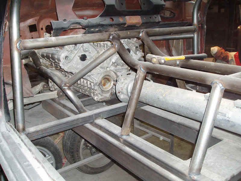

2 Attachment(s)

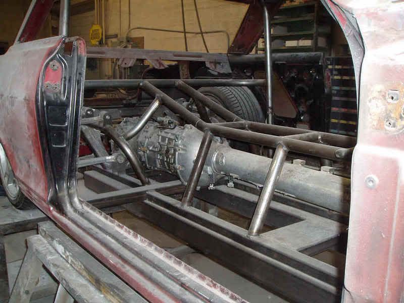

We'll probably do a removable aluminum plate on the bottom, or a series of plates (see photo). My fab guy, Chris, spent alot of time working on race teams back in the day, so he knows alot of tricks. The front points are pretty close to stock, but he has moved them around a little for the narrower car.
The motor is set back a little, it's hard to see, but I think the rear cylinders are midway through the firewall. It is really small, actually it is a cube 20" x 20" x 20". I think it will be really sweet when it is done. Using an IRL motor presents a unique set of challenges, but it will be able to rev over 10 grand. And nothing beats the sound of an indycar motor.

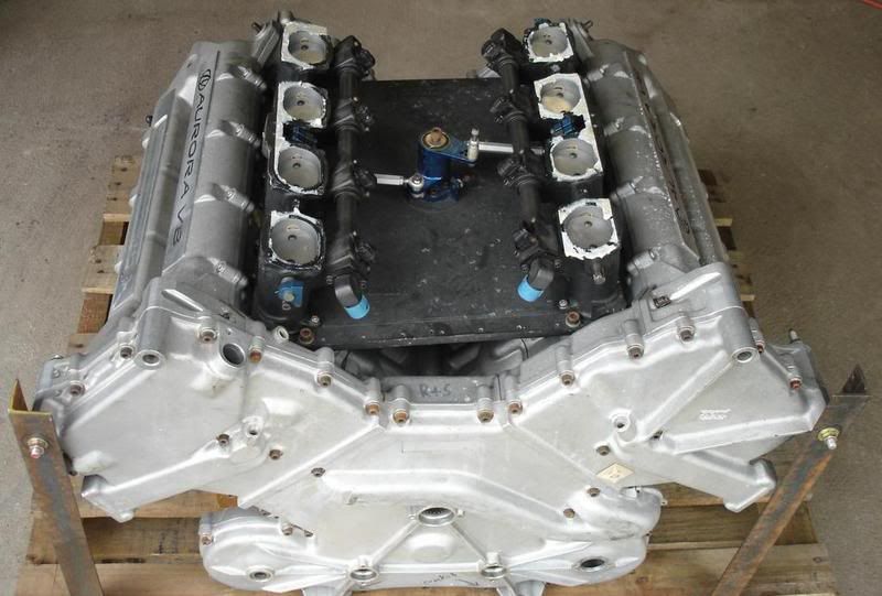

Thanks for good word on the motor. It is going to take alot of engineering to get it to work in a street car. Plus, I just found out that my block is no good. It's not an easy motor to find parts for.
Not really alot going on with the car yet. Still waiting on some parts to show up. I though I would throw out a teaser picture I had draw last June. I made a few cosmetic changes to the car, I think it really changes the whole attitude. I wish I could take credit for it, but it is heavily influenced by Bill Thomas and his "bad bascom" of the early sixties. A really sweet ride. Probably the first guy to fuse a corvette and a nova. Mechanical fuel injected 327 and IRS.

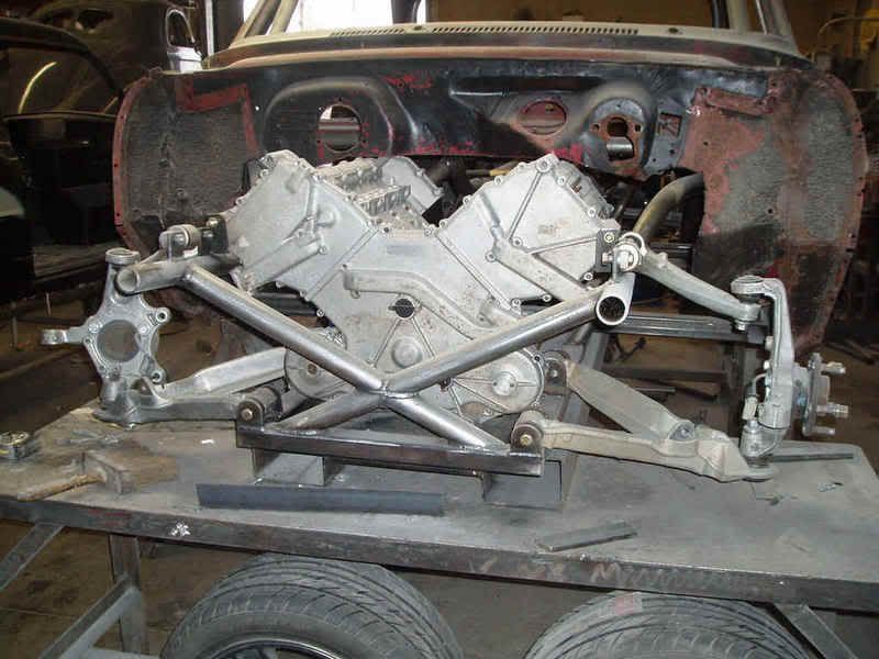

p_call 03-12-2007 04:34 PM
3 Attachment(s)

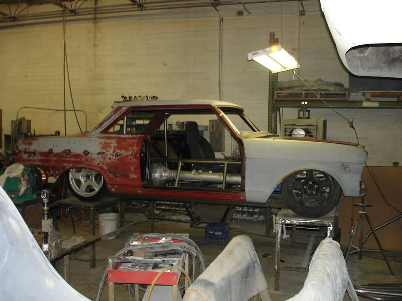

A few progress shots. Motor will set really low in the chassis. The headers may be a little snug...

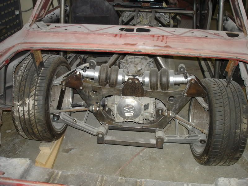

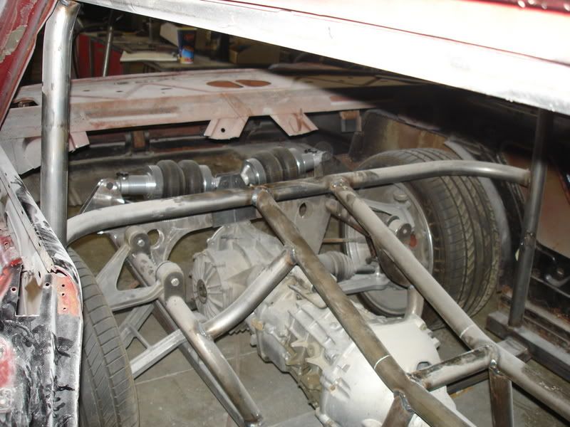

p_call 04-18-2007 05:59 PM
5 Attachment(s)

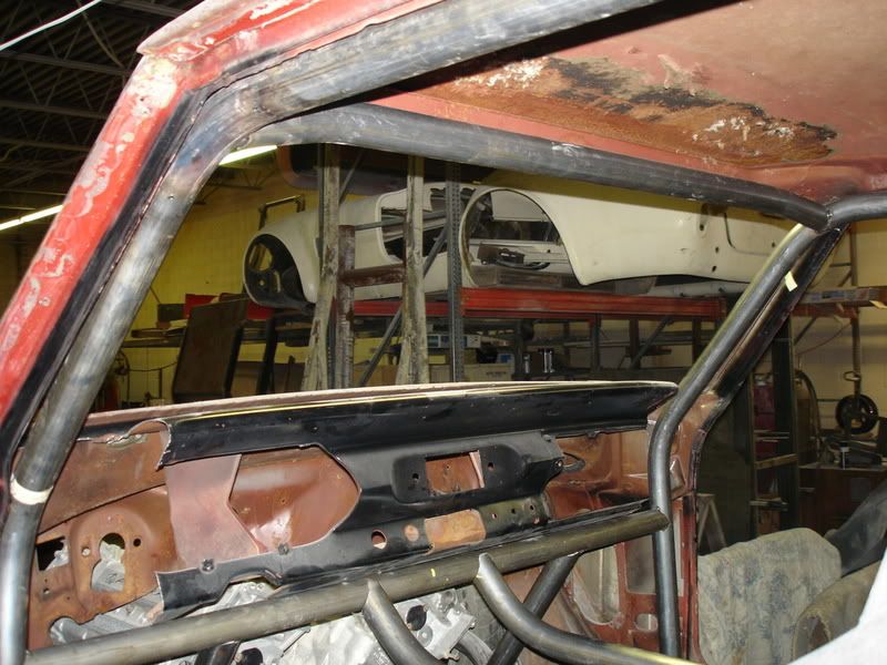

Leadfoot, I have seen John's thread. I try not to look at it too often, it takes too much effort to wipe all the drool off of the keyboard.
I attached some photos. The rear shocks are in the old configuration. I don't have anything new yet, Chris is still working on the rockers.

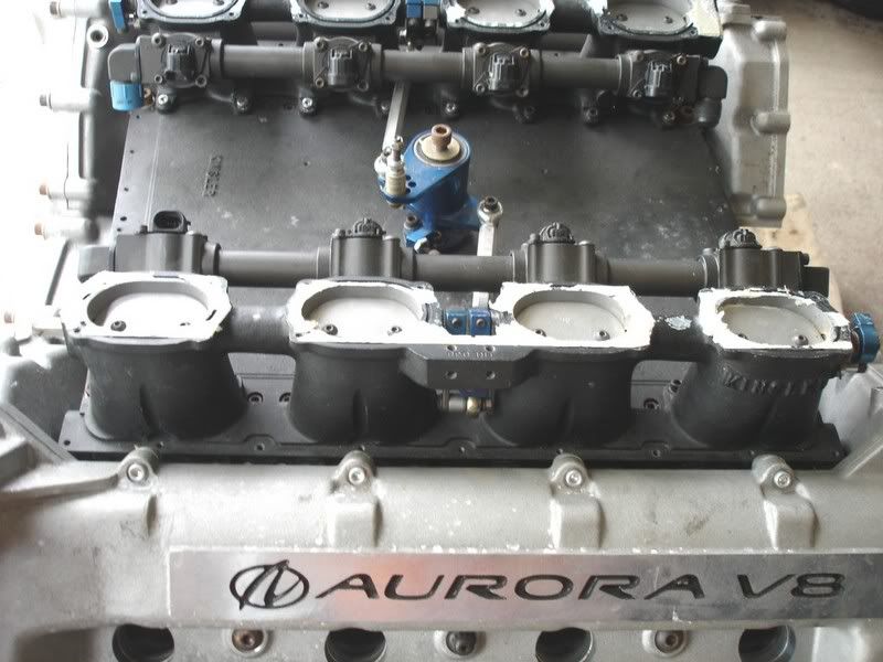

p_call 06-24-2007 07:35 AM
I scored a block and intake off of ebay. The intake is really sweet looking!
http://i184.photobucket.com/albums/x...a/DSC02736.jpg
http://i184.photobucket.com/albums/x...a/DSC02735.jpg

I love the ITB's, they are really slick looking.. The race setup used a box with the filter on top. I haven't decided exactly how, but I will change that and leave them exposed.

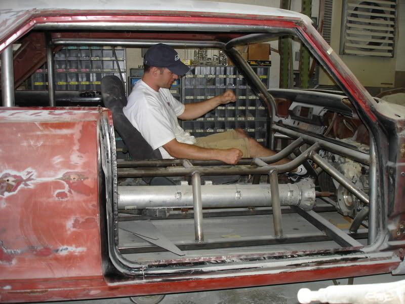

A few! I made a visit Saturday to finalize the details that Chris would be providing in the build. Here are a few shots.
The bags setup is together!
http://i184.photobucket.com/albums/x...a/DSC02748.jpg
http://i184.photobucket.com/albums/x...a/DSC02749.jpg
Checking to see if 6' 3" will fit into it...
http://i184.photobucket.com/albums/x...a/DSC02747.jpg
