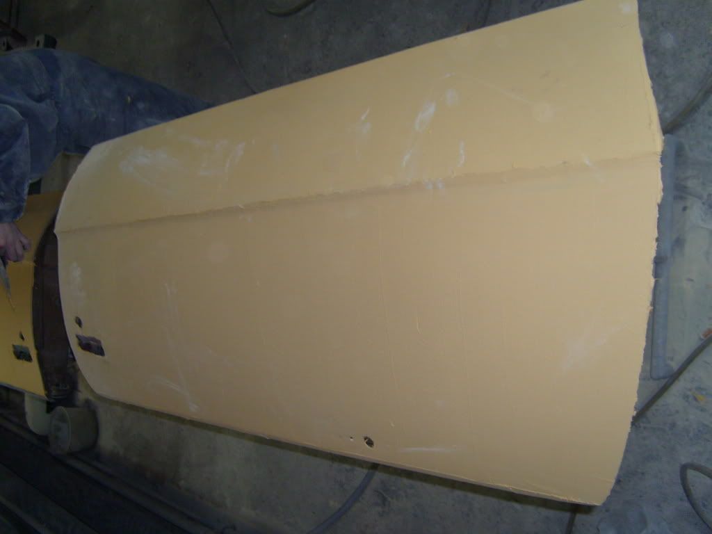

deuce_454 01-26-2007 06:57 PM
5 Attachment(s)
ok..they arent much yet...

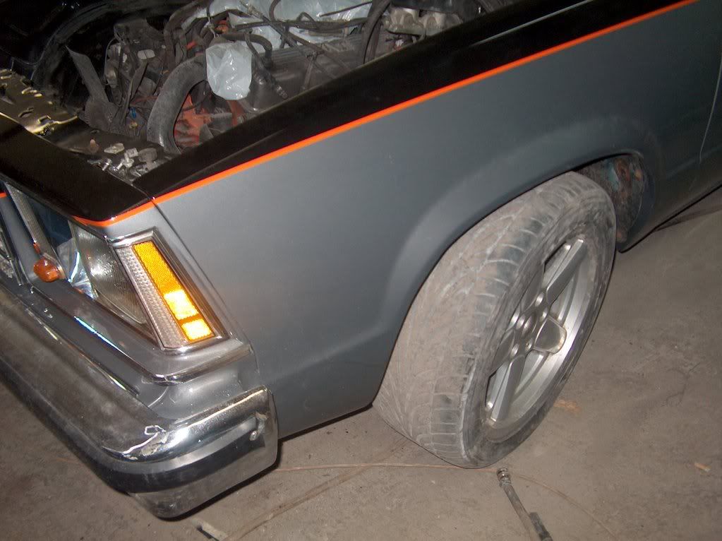

deuce_454 02-04-2007 02:57 AM
5 Attachment(s)
here are some shots of the progress, its getting somewhere now, the frame is ready for assembly and the body is getting ready for underbody paint and blocksanding..

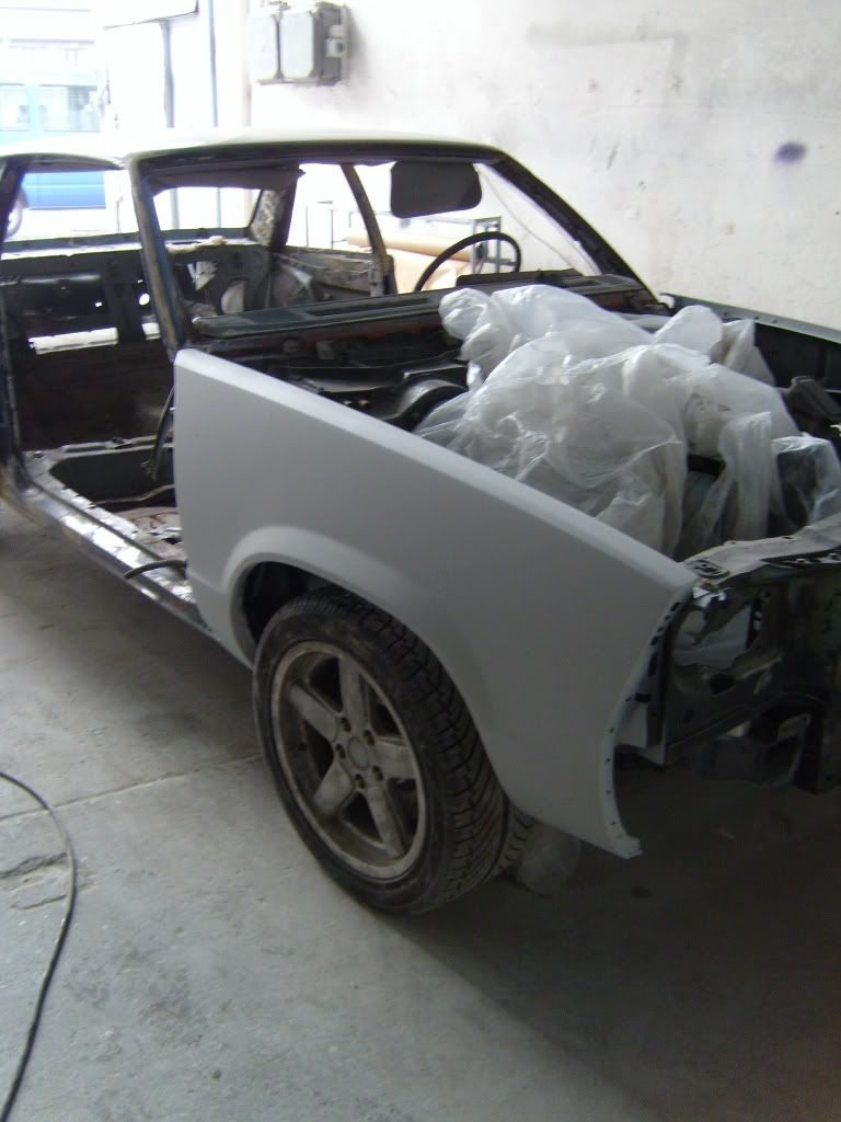

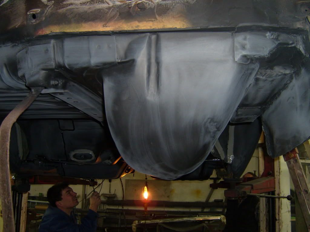

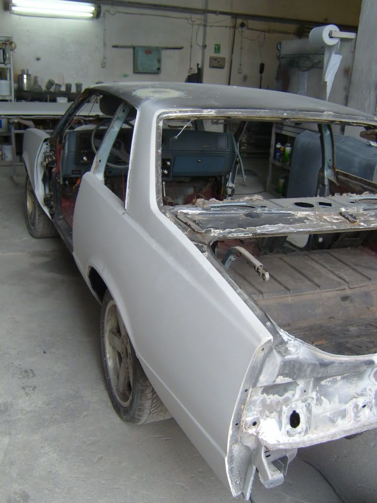

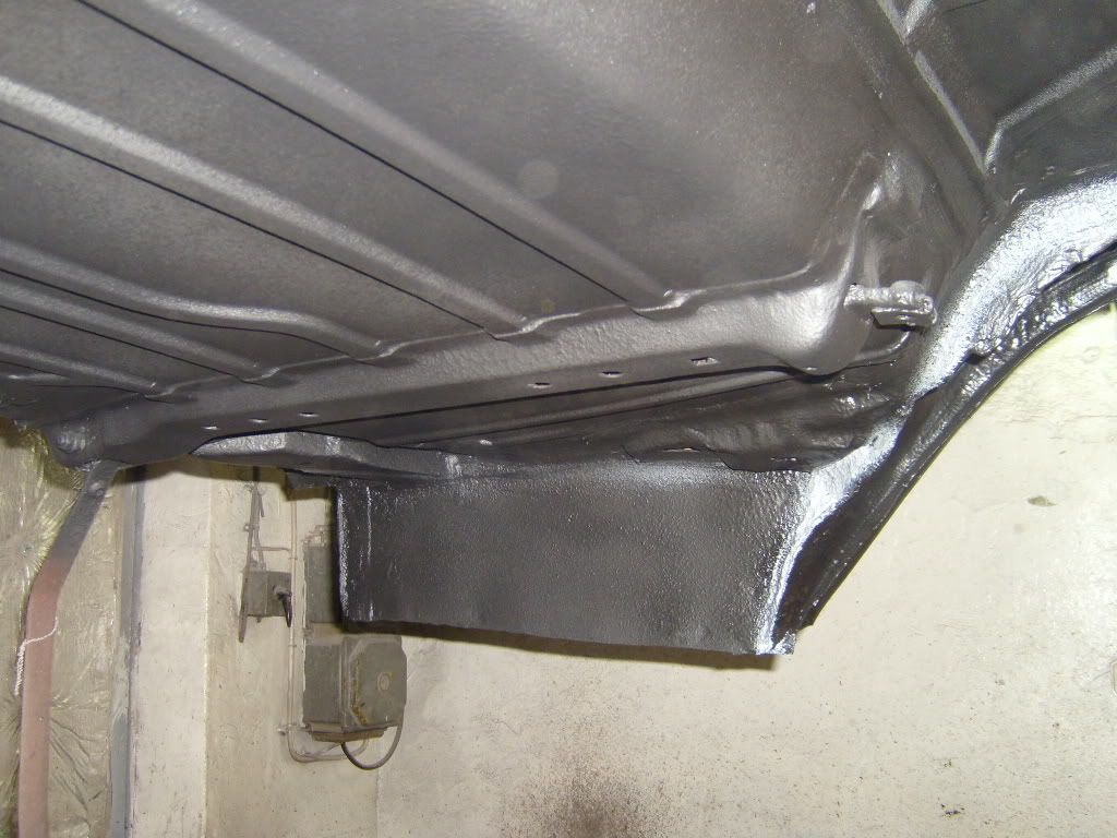

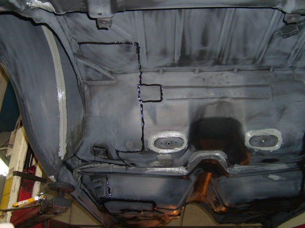

deuce_454 03-06-2007 07:56 AM
the body is comming together, underside is primered, sealed and sprayed... now its time for straightening the body and laying down some paint
http://i155.photobucket.com/albums/s...4/S7000854.jpg
http://i155.photobucket.com/albums/s...4/S7000851.jpg
http://i155.photobucket.com/albums/s...4/S7000862.jpg
http://i155.photobucket.com/albums/s...4/S7000852.jpg
http://i155.photobucket.com/albums/s...4/S7001096.jpg

deuce_454 03-08-2007 06:55 AM
thanx guys! i had it rhinolined both for durability but also for noise.. at least that was my reasoning, also it is going to see quite a few miles, infact it will be my almost daily driver in the non snow/salt months, except when its roadster weather and the trips dont involve parking and leaving the car. and id hate to have rust showing in some area that required frame removal in a year or two...
more pics next week
T Bell 03-08-2007 10:33 AM
I got a question and it may just be my ignorance with the rhino stuff. But why did you do the seam sealer if you were going to rhino line it? It seems like you could skip that step.
deuce_454 03-08-2007 10:49 AM
force of habit... figured that the PU sealer was stronger and id really like to avoid the rhino, cracking in the seams and let water in just where itīd hurt the most.. belt and suspenders..

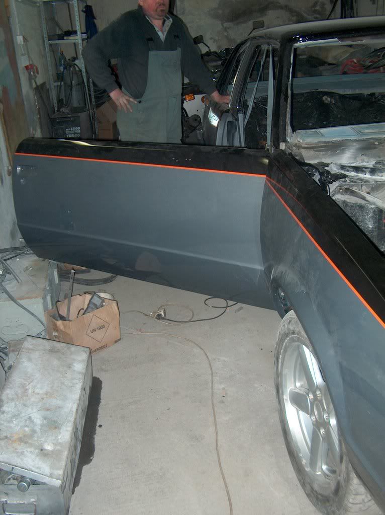

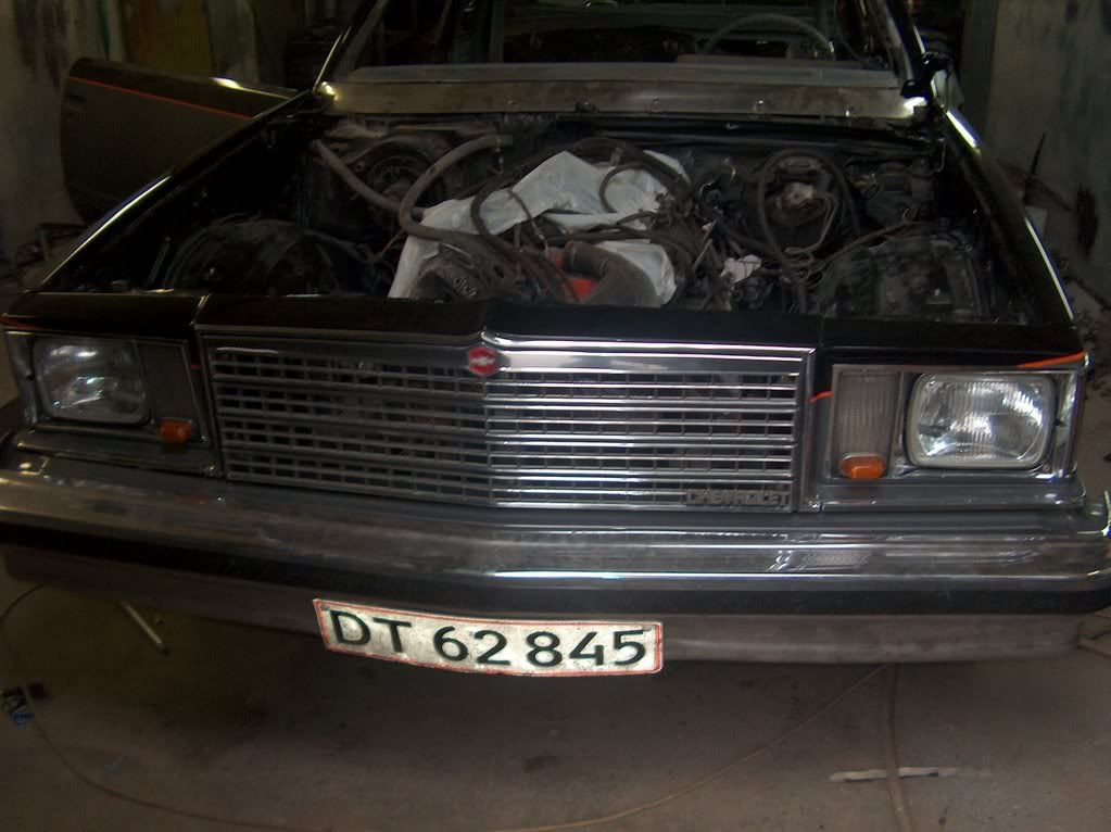

deuce_454 03-24-2007 02:44 AM
got more pics... its now clad in paint, if you look at the front shot youll notice how much like the digital paintbooth rendering it is.. well i guess that will teach me not to say "just like the picture" any way... here are some pics
http://i155.photobucket.com/albums/s...4/HPIM2577.jpg
http://i155.photobucket.com/albums/s...4/HPIM2578.jpg
http://i155.photobucket.com/albums/s...4/HPIM2579.jpg
http://i155.photobucket.com/albums/s...4/HPIM2581.jpg
