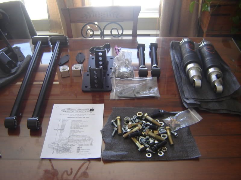

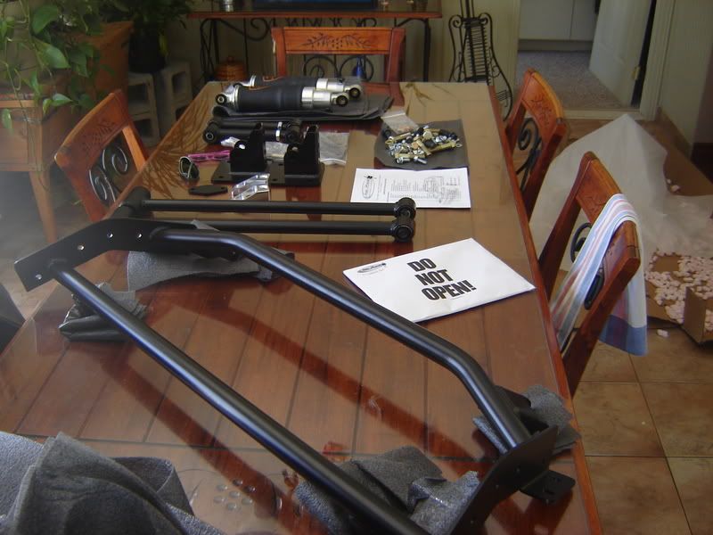

Leadfoot1 03-06-2007 10:52 AM
Well look what showed up today!!!
http://i138.photobucket.com/albums/q...9/DSC06059.jpg
http://i138.photobucket.com/albums/q...9/DSC06061.jpg
:woot:
I'm sooooo tired of that bad back!!! Even my wife is getting tired of seeing cool parts coming in and not making it to the garage (its detached from the house...)
Well, at least its moving along that way... I have an opening for a complete 6.0L (less starter, alt, and computer) for 500$. I'm going to pick it up as 500$ is nothing, even an old school Sb is going for that used and stock. But i'm worried of the price of an aftermarket management system....I never looked into those but now that i have the Twins;
http://i138.photobucket.com/albums/q...9/DSC06041.jpg
(Garrett TO4B's)
I have a little voice in my head SCREAMING at me to get going!!!
The Air bar kit is Killer! No regrets so far. Welds are top notch, hardware is clean and compllete...
So much to do and Summer right 'round the corner....
Lead.
