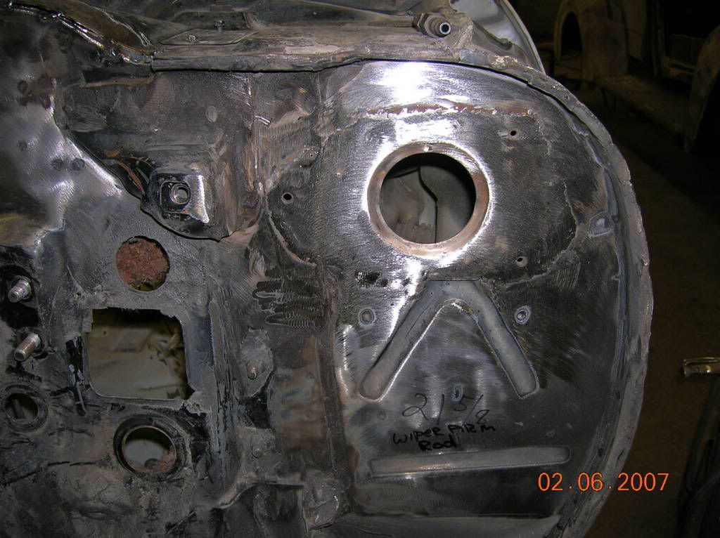

10Seconds 03-04-2008 08:55 PM
Well, I took a different approach. I did not want to see the wiper motor at all, so I cut it out and moved it under the DS fender.
http://i168.photobucket.com/albums/u...TA/070206B.jpg
And done:
http://i168.photobucket.com/albums/u...A/IMG_0580.jpg
Also to do this you will have to lengthen the rod that connects to the wiper motor.
