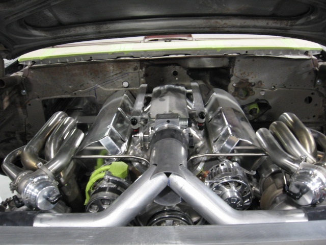

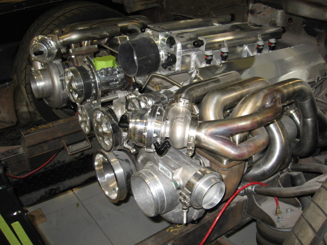

Hey everybody I've been a long time follower of the site. I haven't got a chance to introduce my project yet but thought I'd post a few pics of the turbo manifolds to see what everybody thought. Look for a vehicle introduction and progress pics soon.:cheers:
Thanks, Brent

Bowtieracing 04-25-2007 09:54 PM
Beautifull work!!! How are those headers coated?
Impala TT 04-26-2007 07:57 AM
They are'nt coated, just brushed stainless!

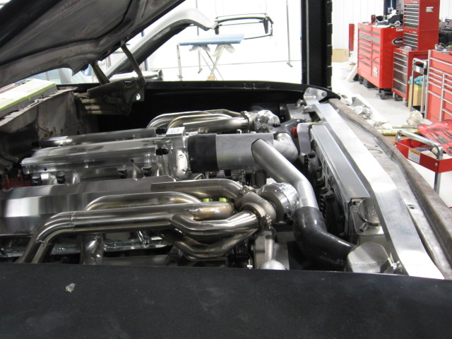

Impala TT 08-18-2007 01:21 PM
2 Attachment(s)
Here are a few more pics with wastegates hung and Oil hard lined. We're building the radiator support and hanging the intercoolers now.

andrewmp6 08-18-2007 10:42 PM
id put a weld around the outside of the pipes and flange besides that everything else looks fine.just remember they are gonna hold pressure so build them stronger then you think. i used too thin tubing before and split it open lol.
Impala TT 08-19-2007 08:35 AM
Flanges are still just tacked, waiting for disassembly for final welds. All the manifolds have been purge welded so far to prevent crystalizing inside. Thanks for looking!!:lateral:

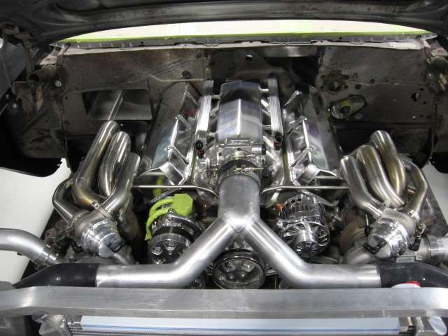

Impala TT 08-20-2007 02:44 PM
2 Attachment(s)
Got a little work done this weekend. Here are some more pics!!:lateral:

customcam 08-20-2007 04:22 PM
killer Engine bay! amazing:thumbsup:
syborg tt 08-20-2007 05:54 PM
looks great - keep the pics coming
dave96dcm 08-21-2007 10:00 AM
Wow that is really nice, I really like the way that you packaged everything to keep it nice and tight. Do you have any pics of the rest of the car?
