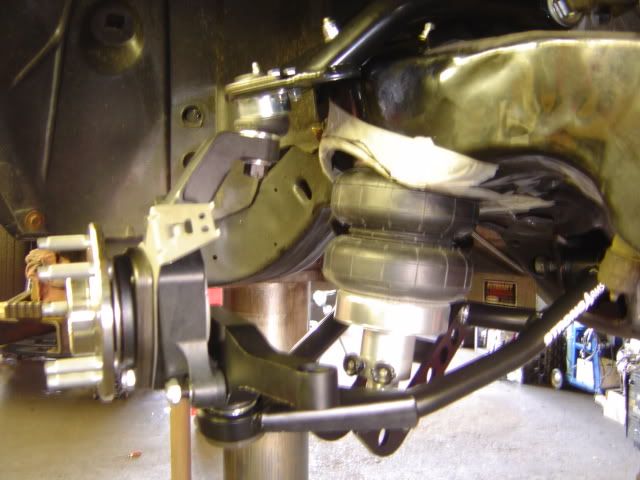

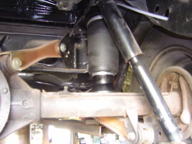

5 Attachment(s)
I've got the engine laid in looks like there are some clearence issues with the centerlink and the pan. I think I'll just fab some slightly higher frame brackets to clear. The 4l80 looks like it will fit with just some slight clearencing above the tailhousing where it bolts to the case

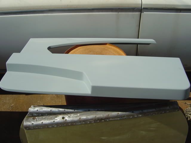

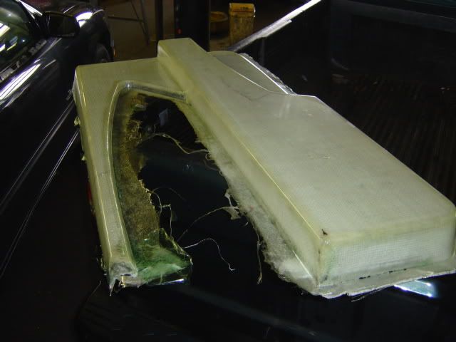

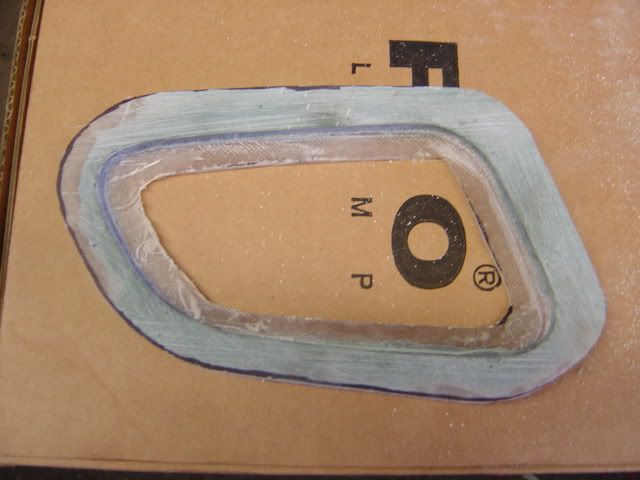

Made some dash progress. Moulded my own dash insert, just need to mould some pods so I can flush mount the gauges. I also made a two piece panel for the VA controller so the controller can sit flush. Waiting on some mig parts to hang the VA unit .
70 chevelle 03-07-2008 03:12 PM
1 Attachment(s)
Controller panel

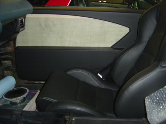

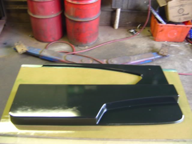

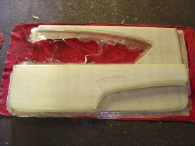

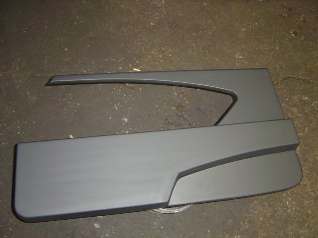

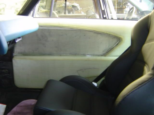

70 chevelle 02-17-2009 10:22 AM
Bringing this back from the dead.

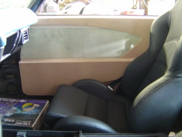

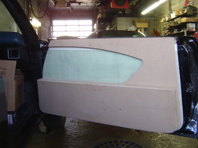

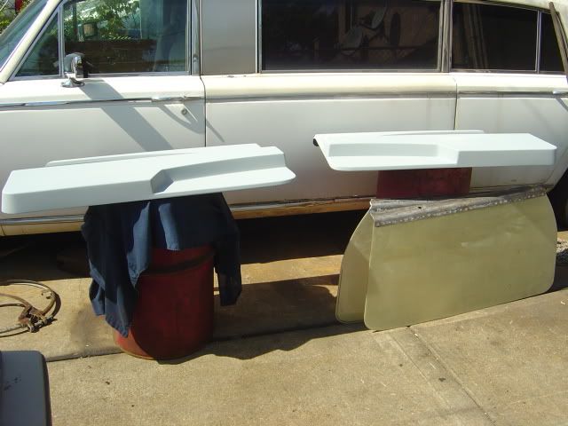

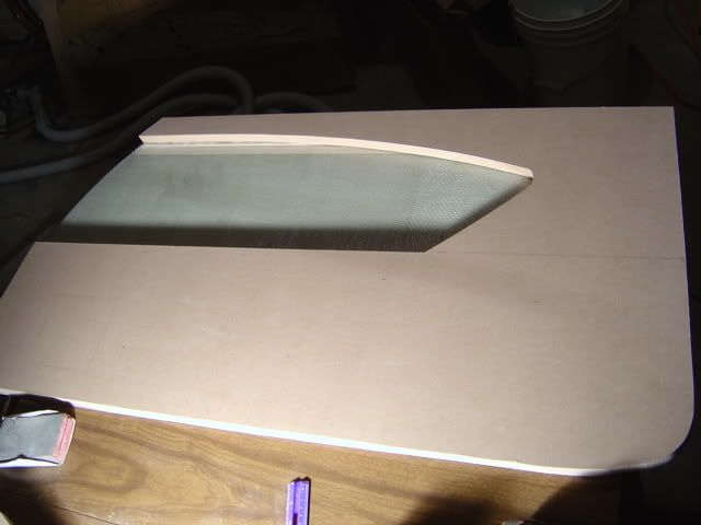

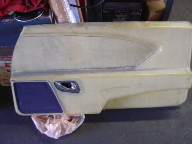

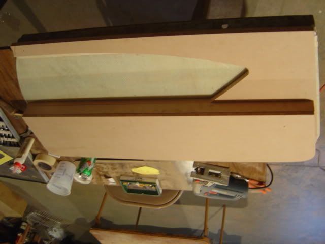

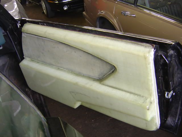

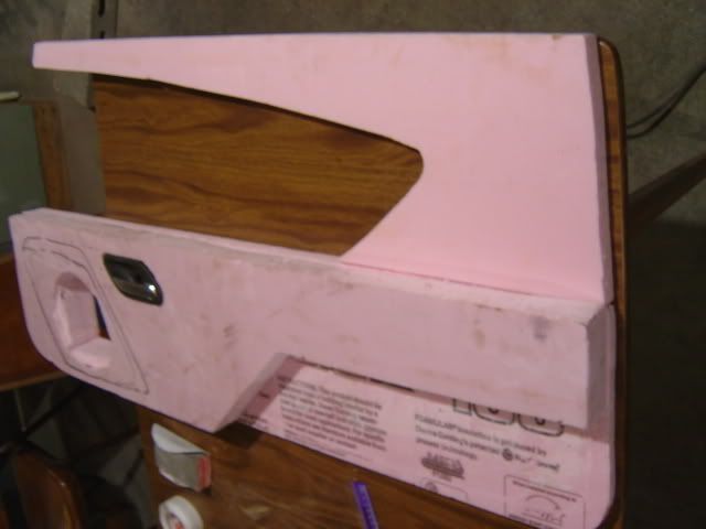

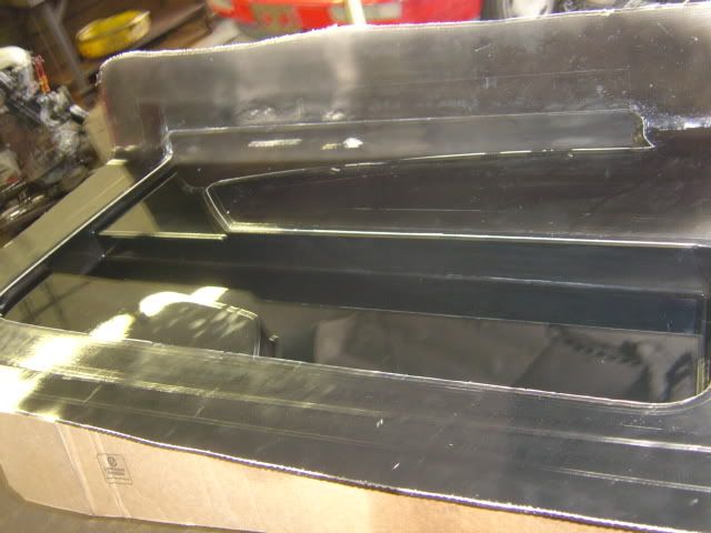

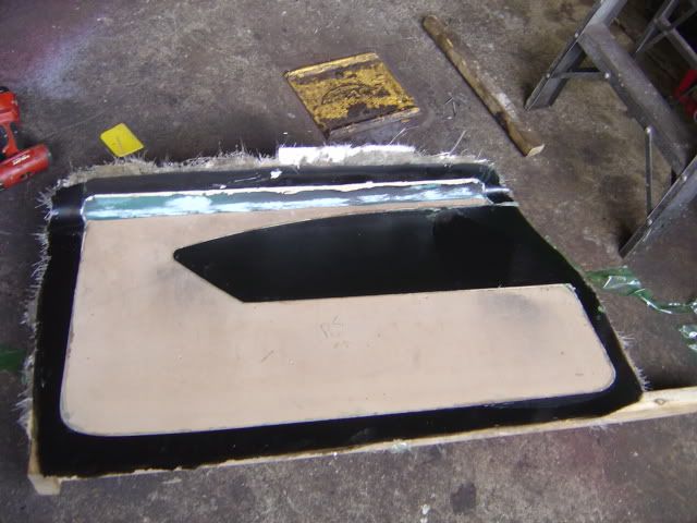

A little progress. I'm taking a shot at my own door panels.
Foam model
http://i148.photobucket.com/albums/s...v/DSC01089.jpg
Im going to use mdf to make the panel so I can make a mold. the finished piece will be fiberglass.
http://i148.photobucket.com/albums/s...v/DSC01088.jpg
http://i148.photobucket.com/albums/s...v/DSC01087.jpg
http://i148.photobucket.com/albums/s...v/DSC01090.jpg
http://i148.photobucket.com/albums/s...v/DSC01092.jpg

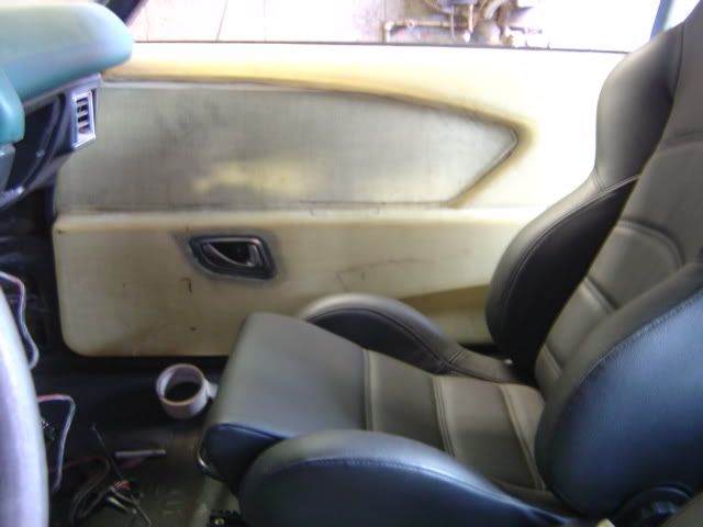

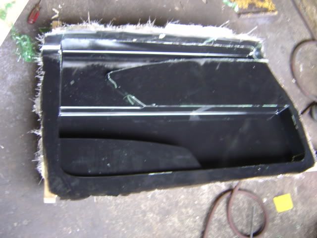

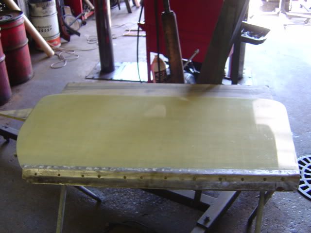

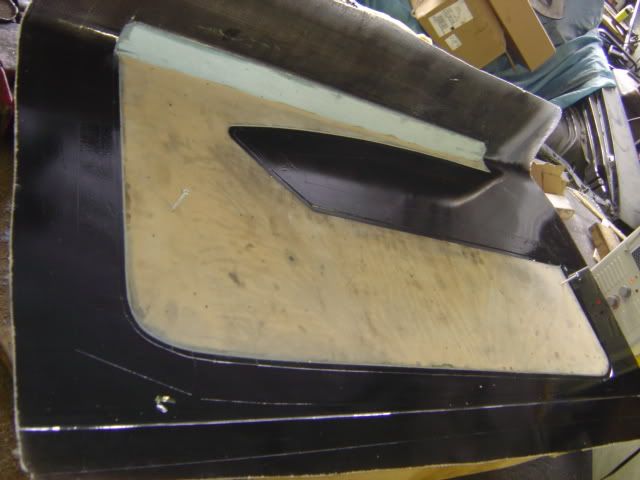

70 chevelle 02-17-2009 10:24 AM
http://i148.photobucket.com/albums/s...v/DSC01093.jpg
http://i148.photobucket.com/albums/s...v/DSC01094.jpg
http://i148.photobucket.com/albums/s...v/DSC01095.jpg
http://i148.photobucket.com/albums/s...v/DSC01096.jpg
