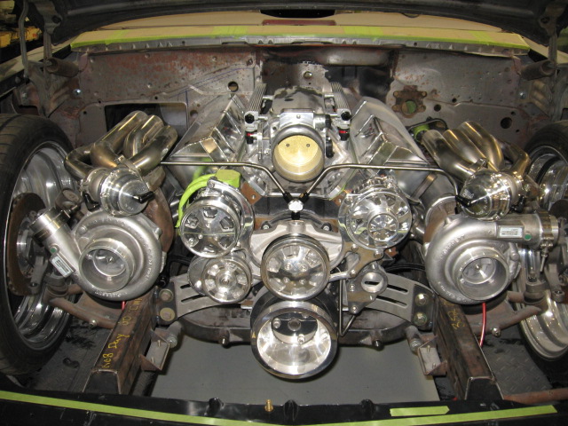

Should be no problem, It will involve a lot of custom fabrication but depends on how deep the customer wants to go with the project! I'll post a few pics of my twin turbo 502, all the fab on it was done in house! Let me know what you think.
Brent |
1 Attachment(s)
https://lateral-g.net/forums/atta...1&d=1186805266
This is an example of a twin turbo big block done in house. Let me know what you think. Brent |
