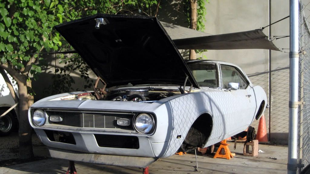

At 23 years old, I am no doubt, a young gun in the lateral-g community. I know some of you have been wrenching on cars for twice as long as I have been alive! So I know, I'm a boy in a man's hobby. But, I'm too busy working on my car to care! I'm cutting my teeth on my first teardown and buildup.
I've been postponing to introduce my project for a while now; I wanted to make sure I had the guts to take the plunge into the money-pit that is pro-touring. However, If you're looking for a high-dollar, frame-off restification, you've come to the wrong place. Besides not having the money, I really don't have the patience or the desire for a 100 point showtouring car. I'm a battle-scar, rock chip kinda guy, and I hope my car will reflect that. I think the name TRACKDAY suits it well, as I truly intend to rip this car up on the track.
As for the buildup, I hope I have the patience to take things slow and not take shortcuts. Yet, I also hope I have the self-control not to get caught up in the hype of having latest and greatest. I also have a "No Bling" rule (although I think I'll make an exception on those carbon fiber spoilers....mmm).
I'm currently installing the following:
Global West Solid body / subframe bushings
Full Global West Suspension, Hotchkis front swaybar.
ATS tall spindles.

Something to consider: You need to be very careful how you use concrete blocks to support heavy objects such as vehicles. The block located at driver side rear is offering little strength in its current position. If you suddenly loaded that block it would crumble instantly. I like to stay away from using that type of block but if it is all you have do the following:
Make sure the block is laying flat (picture it the way it would be installed in an actual wall) take scrap 2x8 or 2x10 whatever you have and lay it on top. This will help distribute the load over the surface. Also make sure the bottom of the block is making contact along its entire face. No pressure points!
Sorry for the lengthy post, just want you to be safe! When I need to block up, I have a bunch of 6x6 leftover PT stock in various lengths. They will even hold up my 20+ thousand pound Mack! (with a piece of C channel across the top to distribute the weight)
Good luck with your project and make sure you get it done before you have kids!:yes:

Thanks Beegs for the heads-up. The cinderblock is actually only supporting the axle (there's no spring on the car). There's a jackstand right next to it that's holding up the car :)
