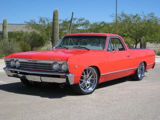

I have QA1's with stock control arms, they gave me a good amount of drop and perform relatively well. However, many people will say that they would buy Chris Alston Varishocks over the QA1's based on quality and tunability.
Here is my car with the QA1's
http://i181.photobucket.com/albums/x...o/IMG_0850.jpg
