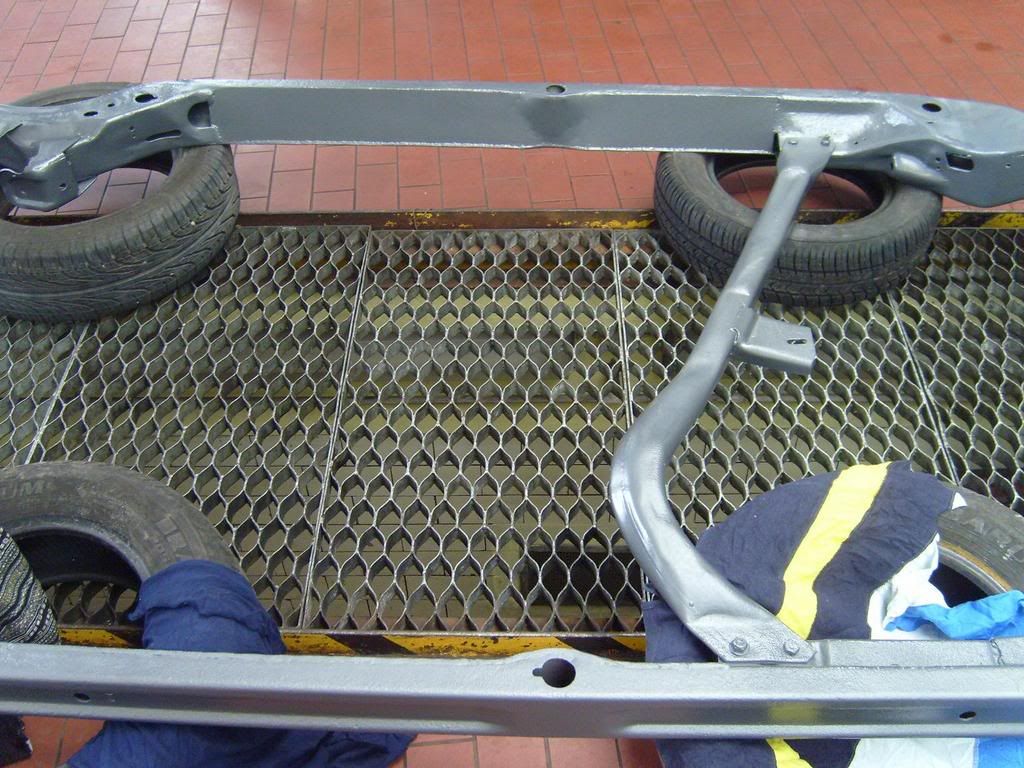

heer is a pic of my frame... it really isnt that big a deal... it can be done without removing the body!
also, stiffer bodymounts are worth considdering... mine are aluminum so prety stiff :-)
