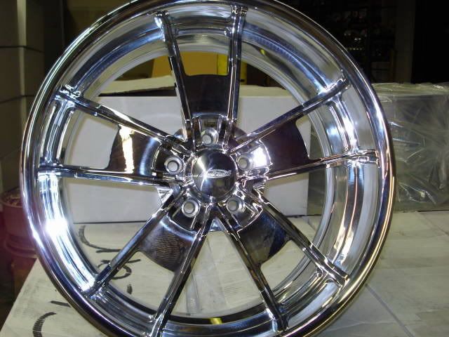

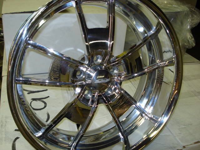

DriverzInc 10-28-2007 12:58 PM
I sent you a PM. The 295/40/20 Is a great tire on a 20x10 but you'll have to tuck it up with suspension and fender modifcations. These cars take a lot of wheel and tire in the back. Check your PM and we can go over all the fitment information for your car.
I think this wheel here would look killer on that car:
http://i37.photobucket.com/albums/e9..._Polished2.jpg
http://i37.photobucket.com/albums/e9...2_Polished.jpg
