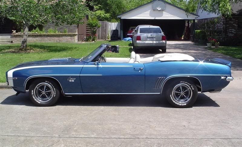

t/a-speed 11-03-2007 07:56 AM
Your so right about the specs, I edited the post to reflect what I think are the right numbers.
I emailed the FIRST people and they use a 730 ecm but the highest duration their people will tune for is 220. I can go my own route and either have it tuned or try it myself.
Since the car is show with some go, I think I can get away with having someone else burn a prom. There seem to be some good companies out there for this.
http://i174.photobucket.com/albums/w...007aMedium.jpg
