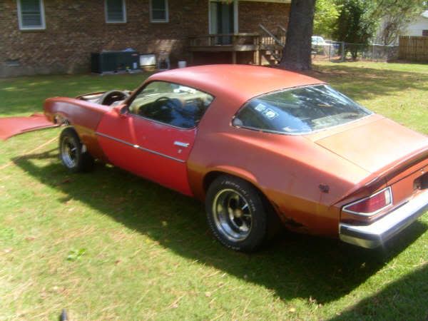

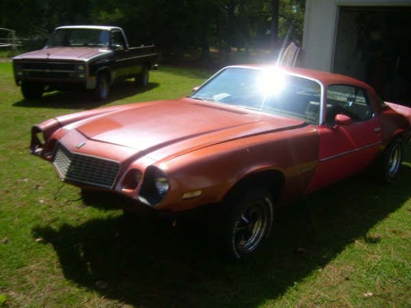

So far, we're on track. I got the Camaro, a 1975 Model with a missing fender, no engine, and minor rust that I can fix. Total cost: $400
http://i7.photobucket.com/albums/y29...l/CAEVQN8F.jpg
http://i7.photobucket.com/albums/y29...l/CA0HMZW9.jpg
I traded some stockpiled parts for a complete T56 setup. I'll need to figure out the mounting and hydraulics, of course, but with your help, I think we can do it!
I also have a complete running 472 BBC that was donated to the cause.
So far I have the car and I have an engine and transmission that should easily be able to give me track worthy performance. I'll need to get a bigger compressor so I can do the paint, otherwise I doubt I'll come in under budget. So I'll be learning to paint cars, too. Not a bad skill to learn, I think.
And now I turn to you, my friends of the road course, for help in making a list of parts to complete the project. Keep in mind what I'm trying to accomplish. I need to beat a stock 1997 M3 around a road course. This car has 250 HP, legendary handling, and will be driven by an above average driver. I've got a 472 ci Big Block Chevy, 6 gears, and a much heavier car that was not designed to run a road course.
