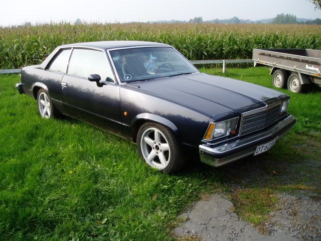

the car was a prety sad 79 malibu, 305, 350 tranny... the previous owner had a halfhearted attempt at pro touring by adding 17 inch bmw rims (very cheap ones at that) and some koni shocks...
some of you might remember my first post "help malibu handles like a canoe"... somone here pointed in the direction of ATS and SC&C and with their help it has progressed a far ways from what it was...
first a pair of before pics:
http://i155.photobucket.com/albums/s...4/P9220071.jpg
http://i155.photobucket.com/albums/s...4/P9220078.jpg

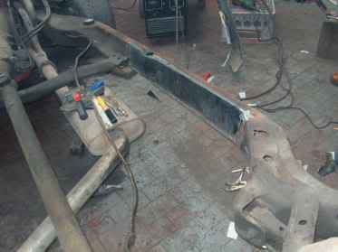

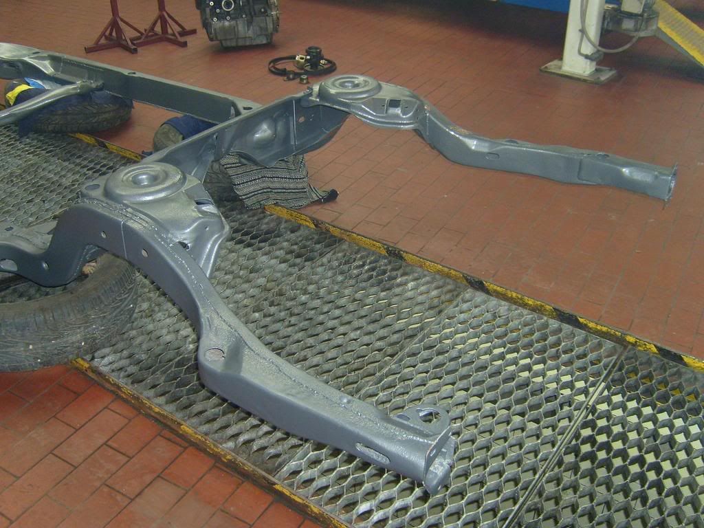

next came the work... a frame off deal, where i after conferring with marcus decided to box the frame and make aluminum bodymounts.. here are some pics of the frame and bodywork:
http://i155.photobucket.com/albums/s...54/during2.jpg
http://i155.photobucket.com/albums/s...udevenstre.jpg
http://i155.photobucket.com/albums/s...4/HPIM2229.jpg
http://i155.photobucket.com/albums/s...4/HPIM1923.jpg

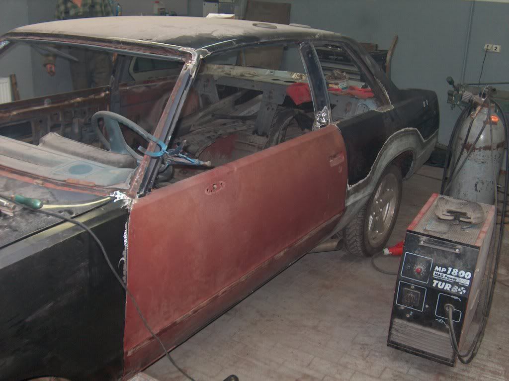

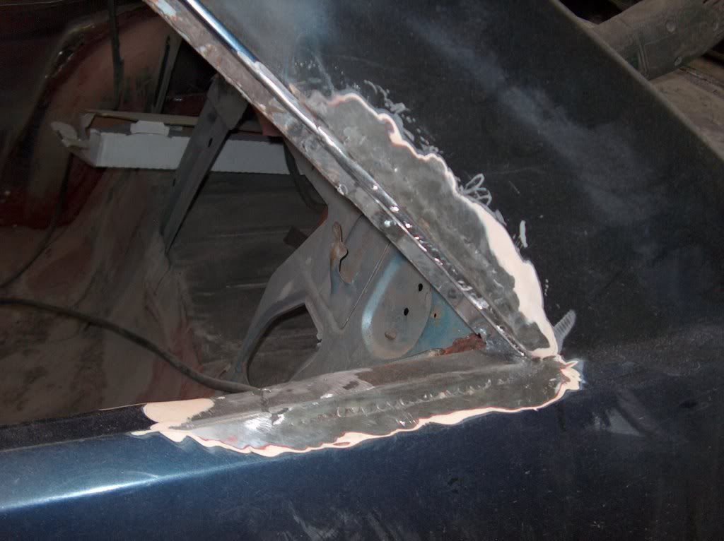

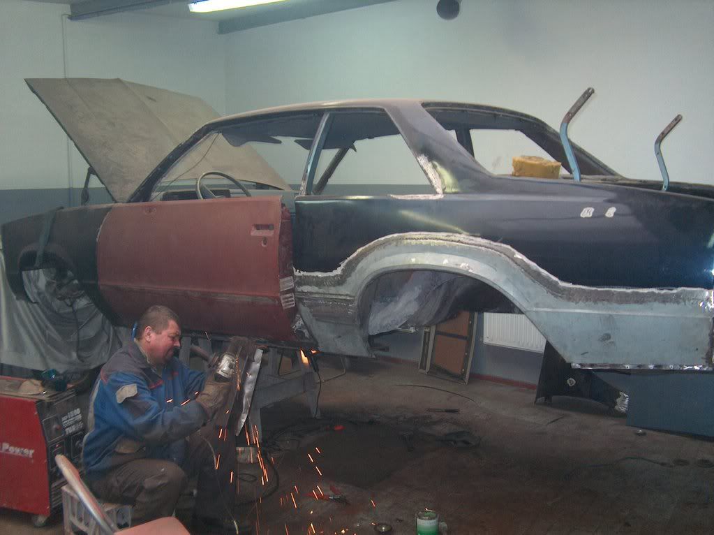

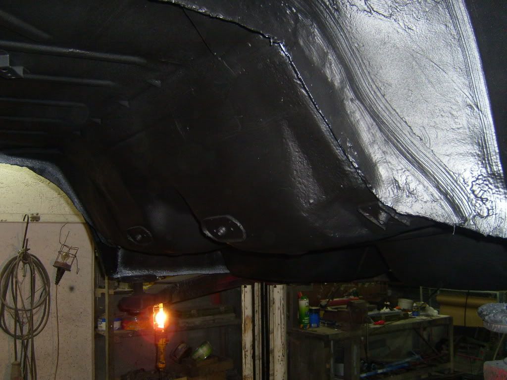

next was ofcourse the body...

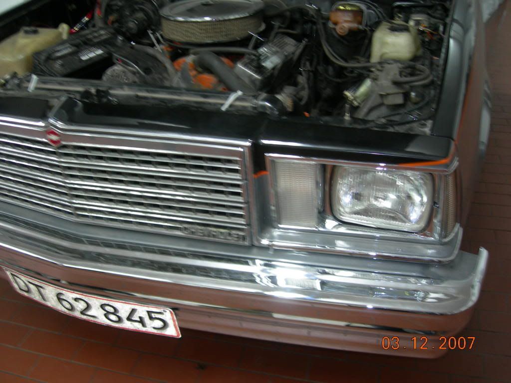

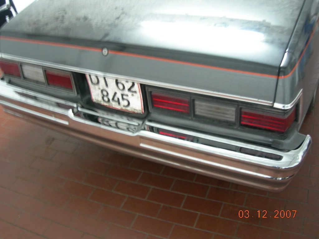

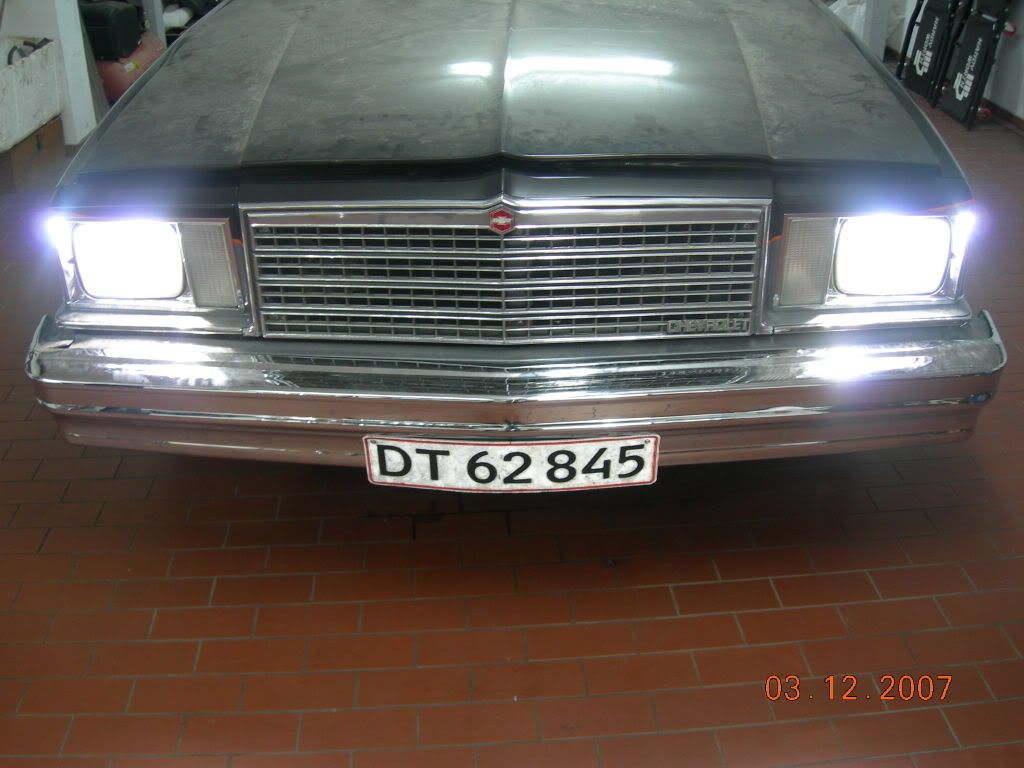

some callong arround procured a nice set of bumpersm new header-panel trim and aome dual HID headlights.. (nothing wromg with alittle bling right?)
http://i155.photobucket.com/albums/s...4/DSCN4646.jpg
http://i155.photobucket.com/albums/s...4/DSCN4648.jpg
http://i155.photobucket.com/albums/s...4/DSCN4652.jpg
the bumpers were simply to nice to cut... so ill have to find some crap ones to cut and tuck some day... but for now its stock

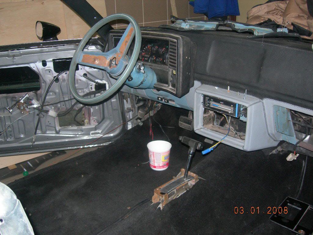

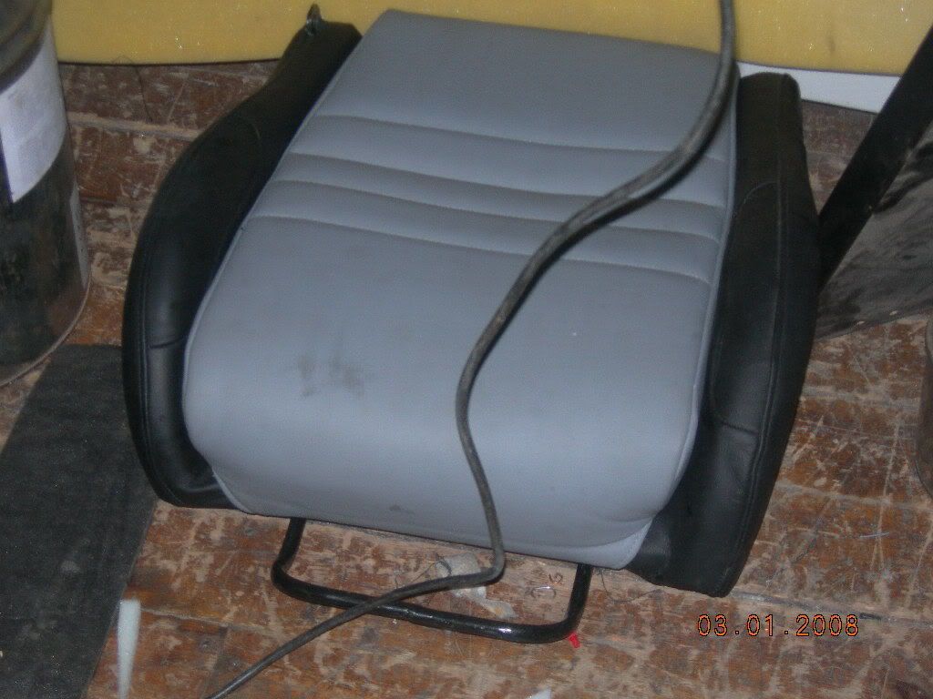

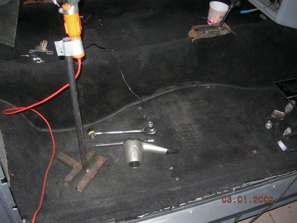

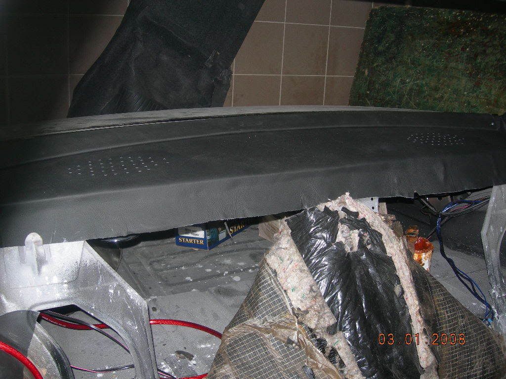

and the last of the update os that the stereo is in, the leather is getting finished up... in matching colors .. the recaros have even gotten a malibu like stitch in the seat to malke them fit in better...
http://i155.photobucket.com/albums/s...4/DSCN4866.jpg
http://i155.photobucket.com/albums/s...4/DSCN4864.jpg
yes thats leather on the dash and pillars :-)
http://i155.photobucket.com/albums/s...4/DSCN4863.jpg
http://i155.photobucket.com/albums/s...4/DSCN4861.jpg
http://i155.photobucket.com/albums/s...4/DSCN4862.jpg

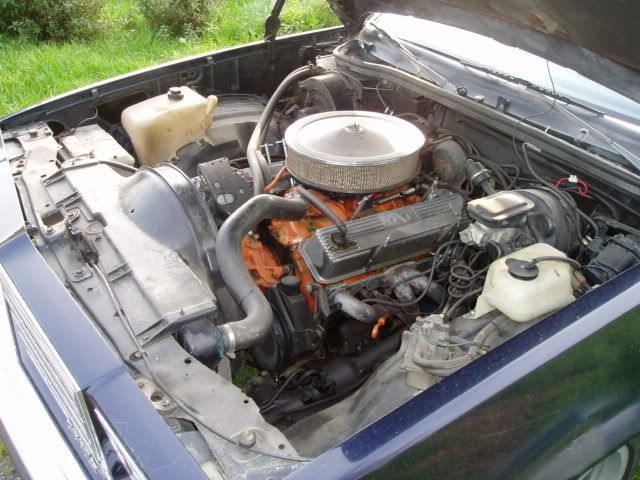

and as a teaser ill post a pic of the engine that will find its way into the bu this comming spring....
http://i155.photobucket.com/albums/s...4/IMG_0551.jpg
http://i155.photobucket.com/albums/s...4/IMG_0451.jpg
i know its not a 1.gen... but i think its a prety good stab at a pro touring car... what does the audience think??
