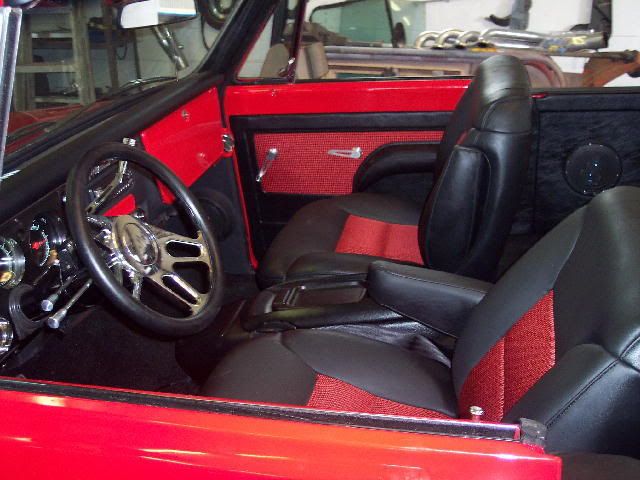

The P.O. had installed some buckets and a console out of a 454ss truck and they where mint but the burgandy seats and carpet didn't go to well with the red paint. I stripped the interior and waited 6 months for my name to come up at Wilson's Upholstery in Cedartown, Ga. They had it done in about a month and I was very pleased with what they did for me. I had them cover a set of 98 tahoe front buckets with the headrest removed and a back seat from a 88 suburban. They also made custom door panels, rear panels for the bed, tailgate panel, covered the dash, dash pad, sun visors, carpet, custom bed rail covers, and a custom speaker box.

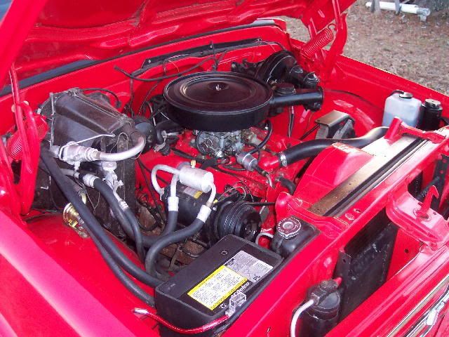

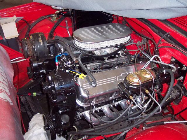

By the time I got it back I was looking to give the 402 a little more power and bought some heads, cam, headers, edelbrock pro flo, roller rockers, and some dress up goodies plus a stall for the th400. During this time I also installed a eaton posi and a set of 3:73's. Got the motor with the new parts and efi back in and all the efi did was give me trouble. All it would do is foul plugs and really piss me off so I decide to sell the motor and the efi and wait for a GENIII motor.

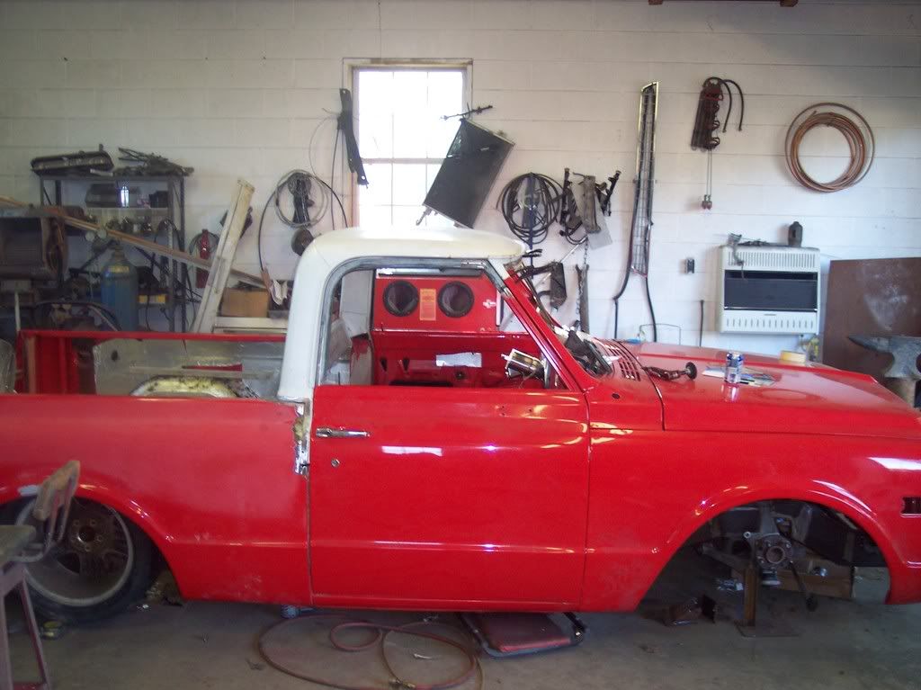

So turns out the bitch had been wrecked at some point and nothing would line up past the firewall on the front rails so we cut them off and made some new one's out of 2x6". We made a crossmember that uses c4 front suspension, it will have shockwaves on the front, c5 front calipers on a 4 corners, nascar trailing arms on the rear, firestones on the rear, 8.8 with 3:73's and locker, bought a lq4 that I will turn into a lq9, maybe a t56, 18 and 20's or 20's and 20's. Here are pics from along the way.
