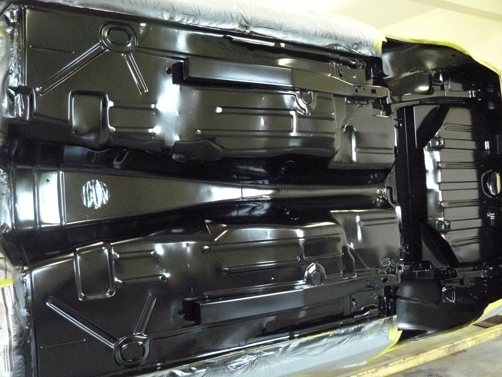

guys there is a new paint out,the brand is Excel and its a single stage urathane that has a perfect finish to it,you can get it in satin or flat,I used satin on all of my car and really am satisfied with it,here is a pic of underside and subframehttp://i1192.photobucket.com/albums/...psa2c85d15.jpghttp://i1192.photobucket.com/albums/...ps3d78da80.jpg
