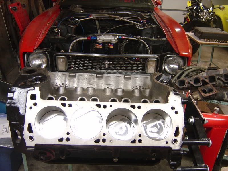

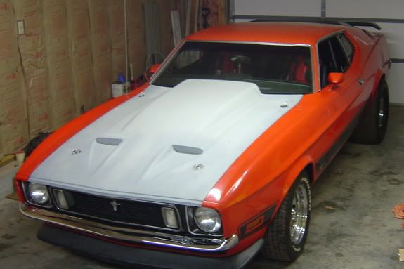

So I figured Id say hi. and show you guys my project. I restored this car when i was 15...did a pretty crappy job body and paint wise, but hey i was young then. Im 22 now and I own my own resto shop.
Any how body and paint will come next year but for now a twin turbo 408cleveland and some big brakes and suspension... I used to be a mild street car... then a twin turbo 351, with wrinkle walls... It sucked to hit any corners at all... now this incarnation will be protouring.
I want to drive it tho, no trailer queern here. so deal with the crappy body and paint.
http://i48.photobucket.com/albums/f2...87_37_full.jpg
http://i48.photobucket.com/albums/f2...87_39_full.jpg
http://i48.photobucket.com/albums/f2...5/FILE0127.jpg
http://i48.photobucket.com/albums/f2...Picture005.jpg
http://i48.photobucket.com/albums/f2...5/FILE0114.jpg
Obviosly its still a work in progress...
TwinTurboMach1 02-01-2008 07:44 PM
more

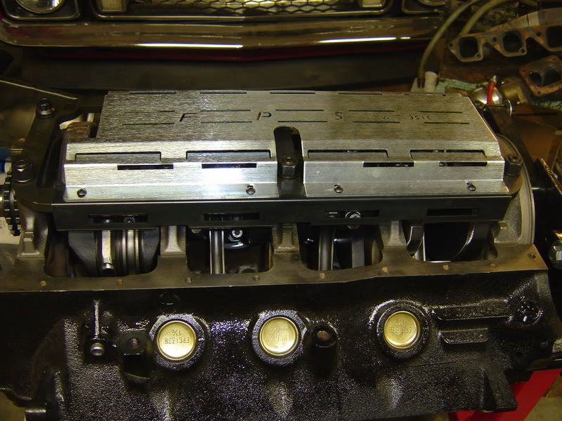

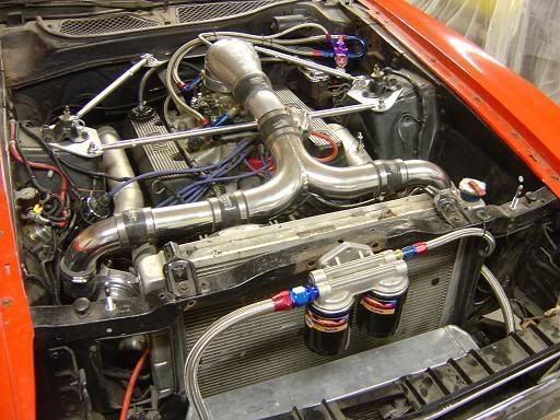

heres the last engine....
http://i48.photobucket.com/albums/f2...5/DSC02847.jpg
http://i48.photobucket.com/albums/f2...87_52_full.jpg
It kinda blew up tho...
so heres the new
http://i48.photobucket.com/albums/f2...Picture071.jpg
http://i48.photobucket.com/albums/f2...Picture069.jpg

TwinTurboMach1 02-02-2008 04:41 AM
Details
Here are a few details for you
408 stroker Cleveland
8.9:1 compression
probe forged 16cc dish pisting
6.00" 4340 forged h beams
4" stroke 3440 forged steel crank
main girde
Heads
ported and polished open chaber 4v heads D3ZE casting
2.19 1.71 valves
cut for guideplates and 7/16 studs
1.7 crane roller rockers
Jomar stud girdles
small .524 lift cam for now, will swap to a custom ground roller when buget allows
Blow through 750DP holley on a torker intake
Trans
4 spd top loader
fidanza 13lb flywheel
centerforce dual friction clutch
Hurst competition plus shifter
Future plans include a TKO 900 with road race .82 fth gear

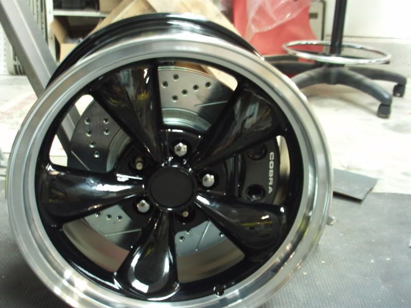

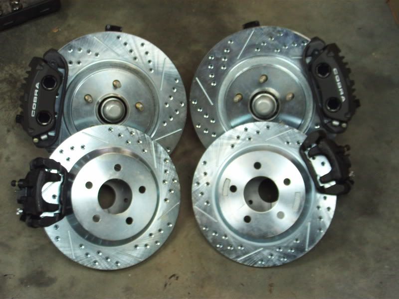

2004 Mustang cobra brakes
Vintage venom braketry and swap kit
13" drilled slotted fronts with 2 piston PBR callipers
Rear 11.65" drilled slotted with 1 piston PBR callipers
Front suspension
1" sway bar
KYB Gas adjust shocks
620lb springs
eurothane bushings
Coming soon
Global west control arms and strut rods
Roller spring pearches
245 45 17 nitto 555s on 17x9 rim
Rear
3.25 gears
Auburn limited slip
31 spline moser axles
Currently 5 leaf spring with eurothane bushings
7/8" sway bar
KYB gas adjusts
315/35 17 nitto 555Rs on 17x10.5s
Im looking to go to a 4 link style rear.
Possibly a modified G bar by total controll. I would need to make custom cross memebers for the upper controll arm and coil over mounts since they only sell a kit for up to 1970.

Looks great I don't trust the big spacer Vintage venom uses between the hub and rotor.Is that a mpg heads export brace/ monte carlo bar?
TwinTurboMach1 02-02-2008 11:32 AM
Actually I loved the idea of the spacer behind the disk rather then ontop of it. First of it looks better, secondly the splines on the stud extend into the space locking it onto the hub. I dont think there will be an issue with it. Posche 911 turbos ... mid 1980's also used a spacer that was around an inch think, maybe more to offset the wheels into the turbo flares. If they didnt have an issue with it Im willing to bet it works fine.
