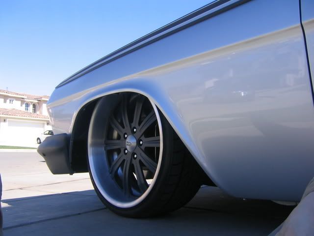

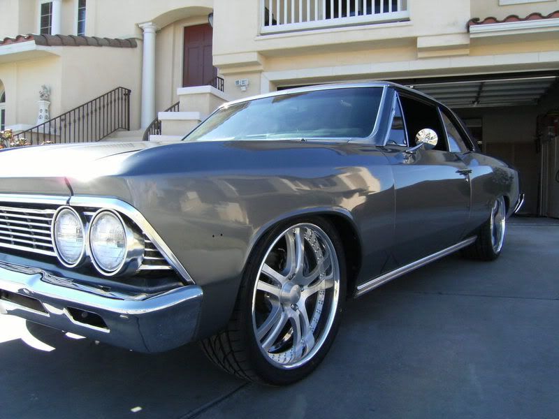

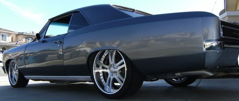

If you must run that 20 front, and a 19 is out of the question, then yes, that will be a better fitting front tire. It's the same tire I put on the front of my Impala, back in the day.
http://i37.photobucket.com/albums/e9...oWheels008.jpg
http://i37.photobucket.com/albums/e9...oWheels002.jpg
