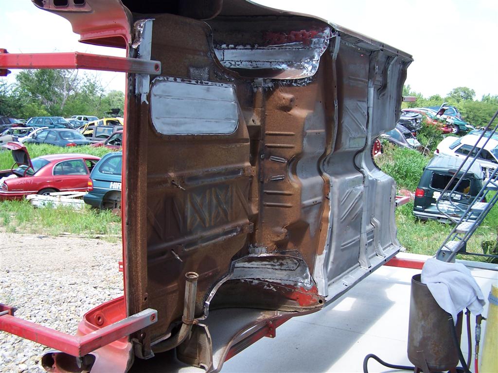

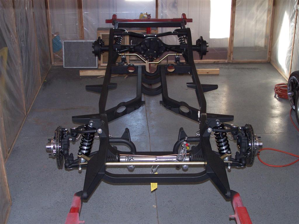

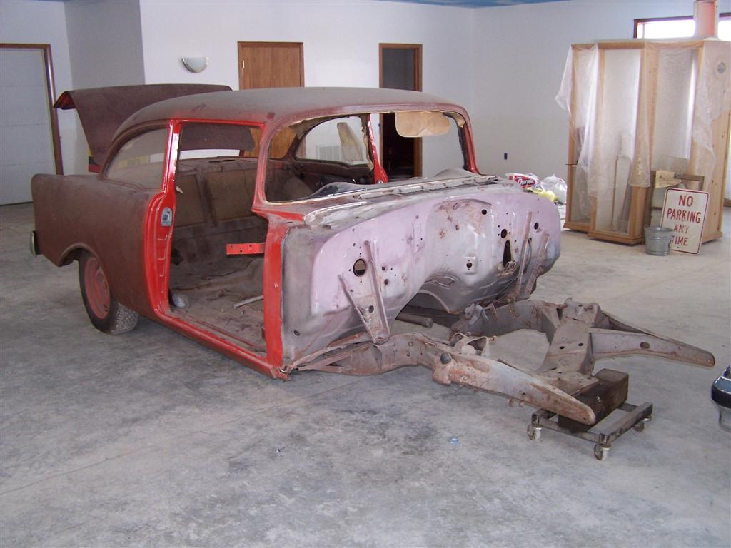

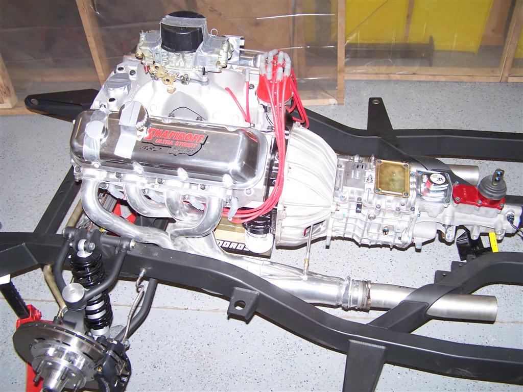

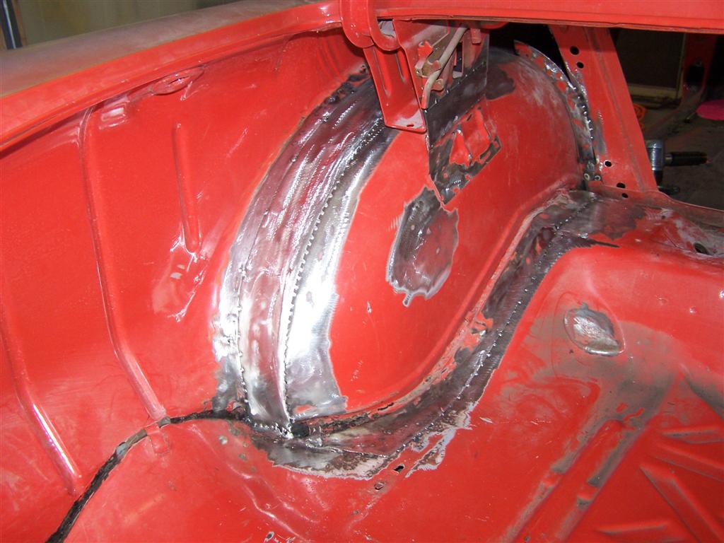

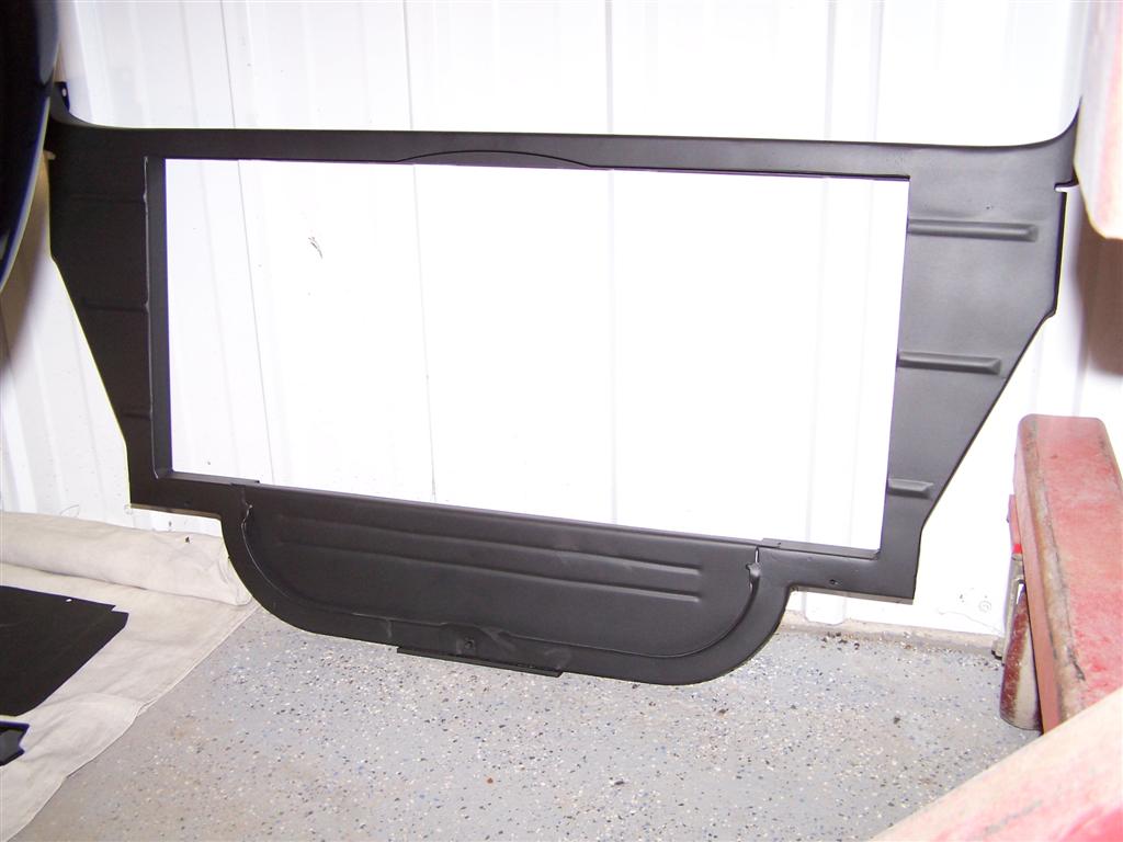

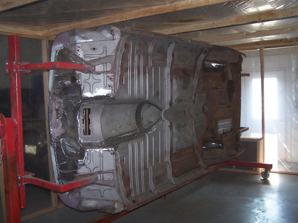

Since the 68 Camaro is in for stitches I've been getting some work done on
"BONER". It's a 56 2dr. on a full AME chassis, 582CI. 745HP. carb. motor.5sp.
trans. Hyd. clutch 9in. Strange diff. 370 gear. Body Mods. will be Subtle on
this project. So far I've--Smoothed and recessed firewall, Raised Trans. tunnel. Extended rockers for a slight channeled affect. Rearranged some
metal on underbody for closer fit to frame. 16in. wide rear tubs. smoothed driprails. Car belongs to Morris Hambly AKA "Slick".He owns a Boneyard so the
cars name is Slick's "BONER". I thought you could use some ShoeBox Cars on
Here. "Attachment 10637
Attachment 10638
Attachment 10639Tellem Jimmy DIDIT"

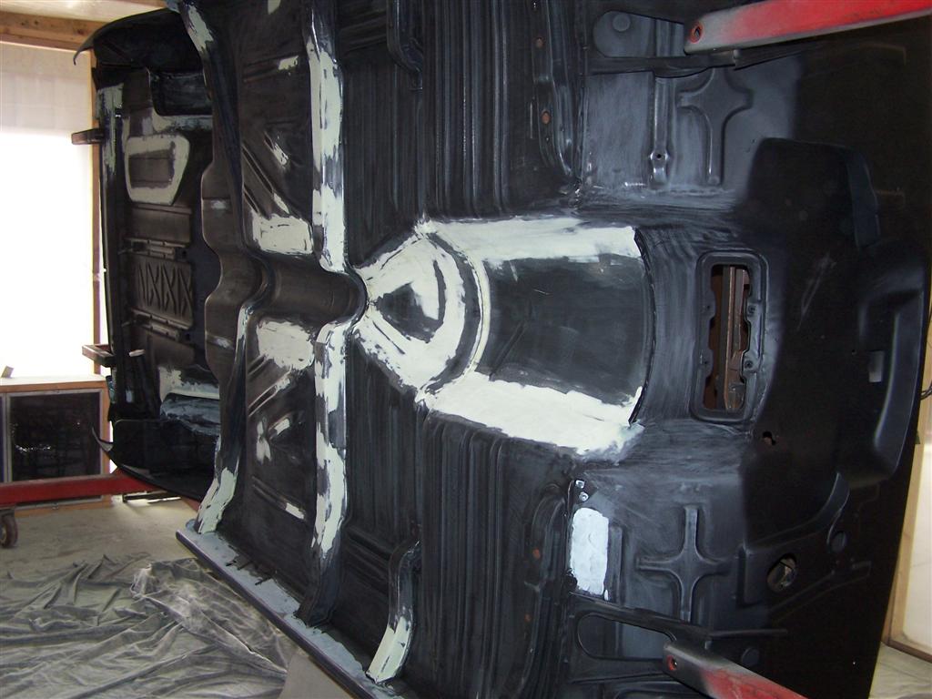

5 Attachment(s)
Thanks for the thumbs up Guys, Rides in The Boner will be good for Phcyco-
theropy. I only get to work on it Fridays ,so it will take some time, but all the
prefab and kit parts will speed things along. Here's a couple more pics.Attachment 10648
Attachment 10649How do I get these pics.to line up across bottom?
Attachment 10650
Attachment 10651
Attachment 10652
