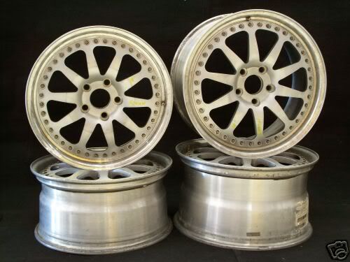

Here's a pic of the wheels!
http://i7.photobucket.com/albums/y29...will/Wheel.jpg
Payton King 02-11-2008 08:51 AM
Not sure of the back spacing on those
but the size is the same as for a C6 vette. 8.5x18 on front and 10x19 on rear.
The stock tires for a C6 are 245/35/18 and 285/30/19 rear.
Would you like to part with those? My 69 is running a set of C6 rims and tires and those would bolt right up...assuming they are prototype for the C6.
I know a C6 back spacing for the rear is different on a C5 as compared to a C6...
Did I mention that I would really like to have those on my car?
DDY RCKT 02-11-2008 11:46 AM
:willy:
My wheels!!! :captain:
Can I go with the 255F and 295R, you think? The tires I want, I can't get in a 285, so I kind o fneed the 295. I can run the 245 in the front, but if the 255 will work, I'd prefer those.
