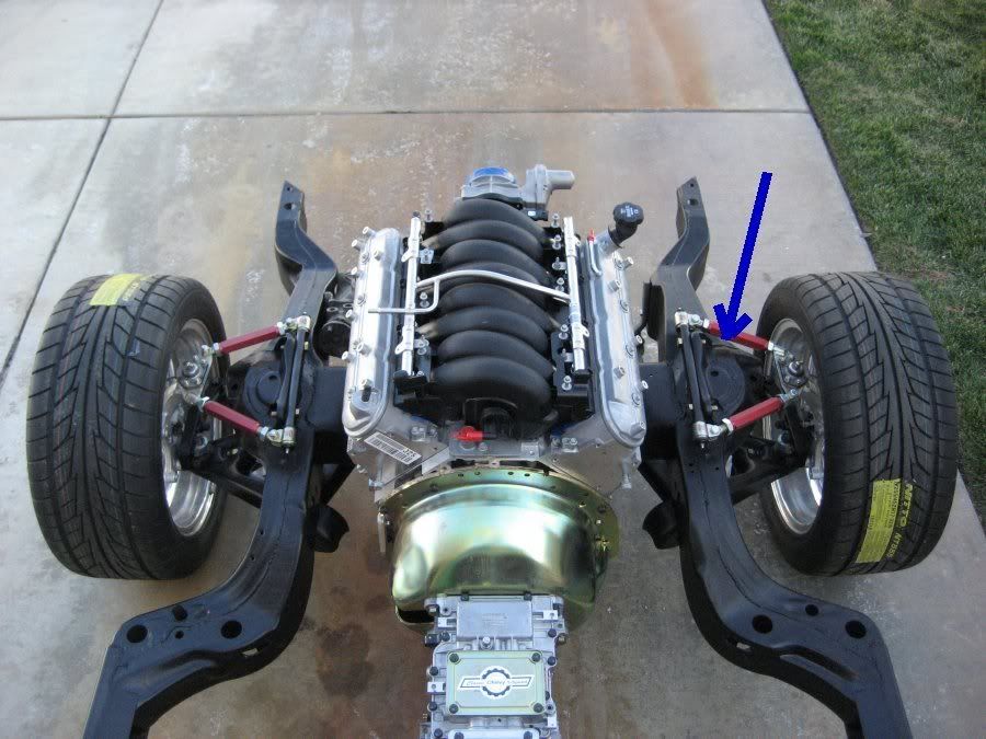

Here are a few of the rolling chassis. Still have to run the brake and fuel lines as well as mount the rear shocks.
http://i75.photobucket.com/albums/i2...S/th_SS196.jpghttp://i75.photobucket.com/albums/i2...S/th_SS203.jpg
http://i75.photobucket.com/albums/i2...S/th_SS209.jpghttp://i75.photobucket.com/albums/i2...S/th_SS214.jpg
I didn't box the frame as this is an original LS-6 Chevelle w/ build sheet. Even though it's not a numbers matching engine I didn't want to do anything permanent. Later, if I can find another frame I'd like to box and strengthen it and swap it in.

Blown353 02-11-2008 06:51 PM
Word of warning...
It appears you are running Global West CNR-42 upper arms (originally intended for B-body spindles) and what I'm guessing are ATS "tall" spindles.
Just a warning... you may be in for a surprise at the alignment shop with that combo. Mark from SC&C and I were just working on this very problem (I'm changing from B-body spindles to ATS tall spindles, I already have the GW upper & lower arms on the car with B-spindles currently) and even with no shims the least negative camber I would be able to achieve with the GW CNR-42 upper arms is -2.2 degrees. The ATS spindles have 2 degrees less KPI than the B-body spindles-- thus the moment you bolt the ATS spindles on you now have 2 degrees more negative camber than the B-body spindles. The GW CNR-42 upper arms are sized so that with B-body spindles, no cross shaft shims, and an in-spec frame you'll get about 0 degrees of camber. So once you swap out to the ATS spindles you are looking at a nominal -2 degrees camber with the CNR-42 upper arms with no shims!
GW even states on their webpage that the CNR-42 "negative roll" (B-body) upper arms can't be used with ATS tall spindles... and this is because the change in KPI between the spindles makes the arm too short and results in too much negative camber. You're simply out of adjustment.
You might want to think about alternatives now while you have an easy to work with rolling frame. GW says their standard length upper arms will work (they're longer and thus give you more camber adjustment range with the ATS spindles) as would SPC adjustable uppers (which is what I'm changing to... no more shims and a much larger possible adjustment range.)

7TSS 02-11-2008 09:46 PM
Thanks for the comments guys.
Blown353,
Thanks for the advice. Yesterday as I was finishing up the install of the front suspension, I noticed that there was a lot of negative camber without any shims. I was going to call GW and/or Tyler to ask about it. Now I have my answer.
I wanted to use the SPC arms but since I already powdercoated my frame I didn't want to chance needing to cut the gussets for the cross-shaft mounts. I guess that leaves the GW stock spindle replacement to match their lowers as the next alternative. Any other brands you'd recommend?
Tom.A 02-11-2008 10:59 PM
Goodwin,
You car is gonna be nice:thumbsup:
X2 on Blown353 comments. And further more I started with the GW stock spindle uca's. On my car (69 Chevelle) I still had a problem with the gussets hitting the front part of the arm. GW said they would fit with out any cut, but that was not the case for me. I don't blame you for not wanting to cut an LS6 car, but it is not really that bad. I opted to change to SPC's. In picture below you can see where I cut. I also just got the new lower SPC's and waiting for Varishock coil overs to arrive next week before I install them. You might want to also talk with Marcus or ATS about the baer trackers as Tyler said they would have an ill effect for our front steer cars. I am a nobody to give advice rather just passing on what I have been told. I look forward to seeing updates on your build. IMO the GW's lower's look nicer than the SPC lower however I took Marcus's advice that the SPC's were better from his testing.
