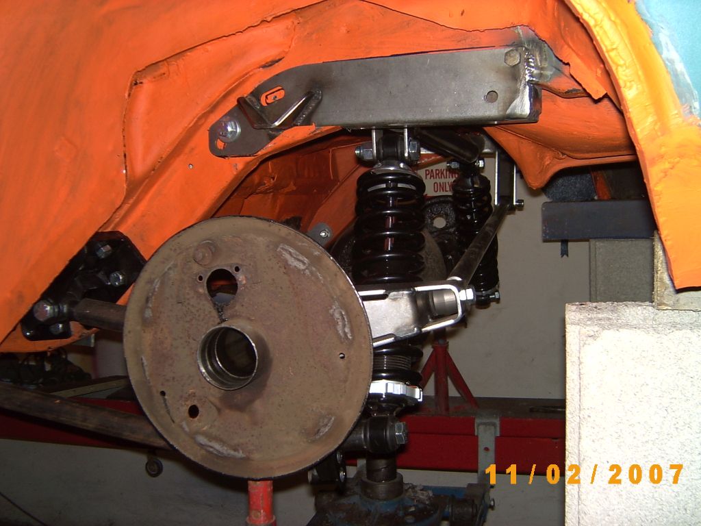

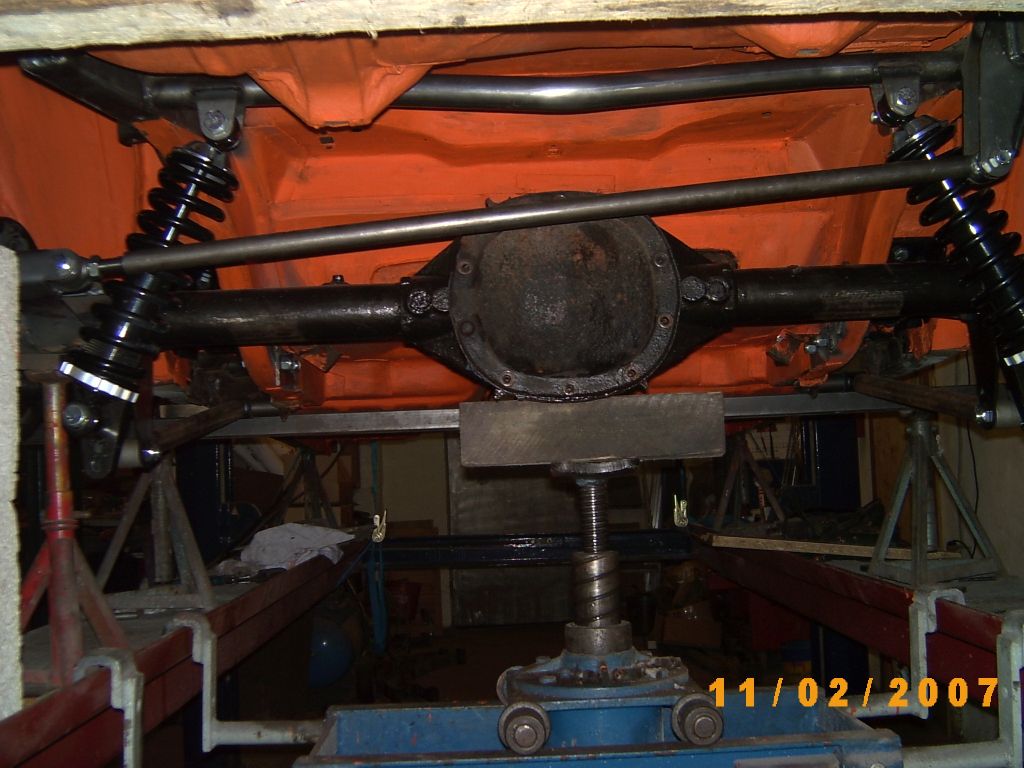

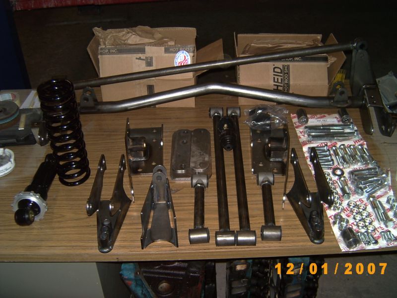

el-camino 02-12-2008 10:26 AM
hi,
my wifes 1977 Olds Omega, X-body, i originaly equipped with leafs.
i hate leafs.
but no parts for this car availible.
hmm, i bought akit for a 67-69 Camaro from HEIDTS at
http://www.timshotrods.com/
great stuff
http://www.chevy-elcamino.com/2007-01-12_01.jpg
with some modifications, the olds runs now with the 4-link and i can say:thumbsup:
http://www.chevy-elcamino.com/2007-02-11_01.jpg
http://www.chevy-elcamino.com/2007-02-11_03.jpg
i love it in fast corners and on long autobahn carves:hail:
not shiny but great working, poor man´s 4-link

Frank that is good news at i dont need to tear down the dse shock mounts..It saves a lot . I want to go with 3" mandarel bent as tight clearance exhaust system as possible. Did i understood at it goes over the g-bar crossmember in empty nest ?? But where it supposed to routed in vegas car ? Under the shock crossmember ? and wich side of the coilover ?
Payton i have exact same goal as you have, 90% street and sunday track driving. :thumbsup:
Klaus, does your panhard affect exhaust routing ? Looks really good system too.
