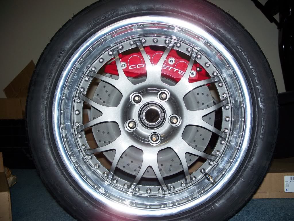

I have the z06 front and rear brakes that iam putting on my 79z its hard to find wheels that work but i went with the Forgeline WC3 wheels and they fit but close. if you use the kore3 template that will do the trick but if you use the kit that Tobin has the front center caps wont work due to the hub sticking out. But for the quality and customer service kore3 is great. and get the rear e-brake set-up nice piece
http://i224.photobucket.com/albums/d...z/100_0244.jpg
