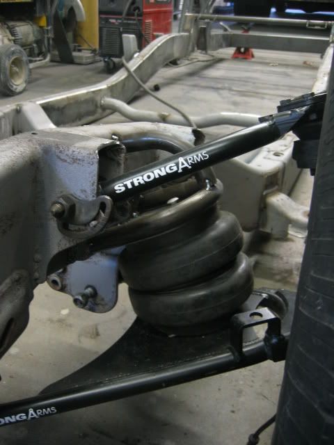

Here are the uppers

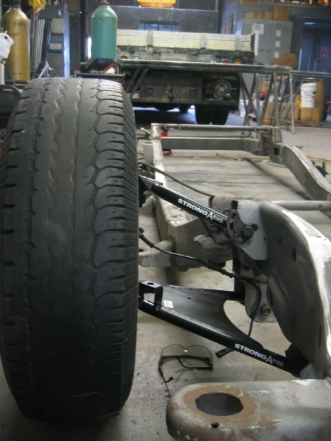

lowers are under frame, so I don't think it'd be all that easy to raise those ones up compared the the fronts, seems like the amount of work to do that would just lead to doing full tube anyway.

I know it's a huge project and I don't see why I could do it, to move those control arms up would be a nightmare with the way they tie into the cross member underneath the motor. I guess I have some thinking to do on it.
