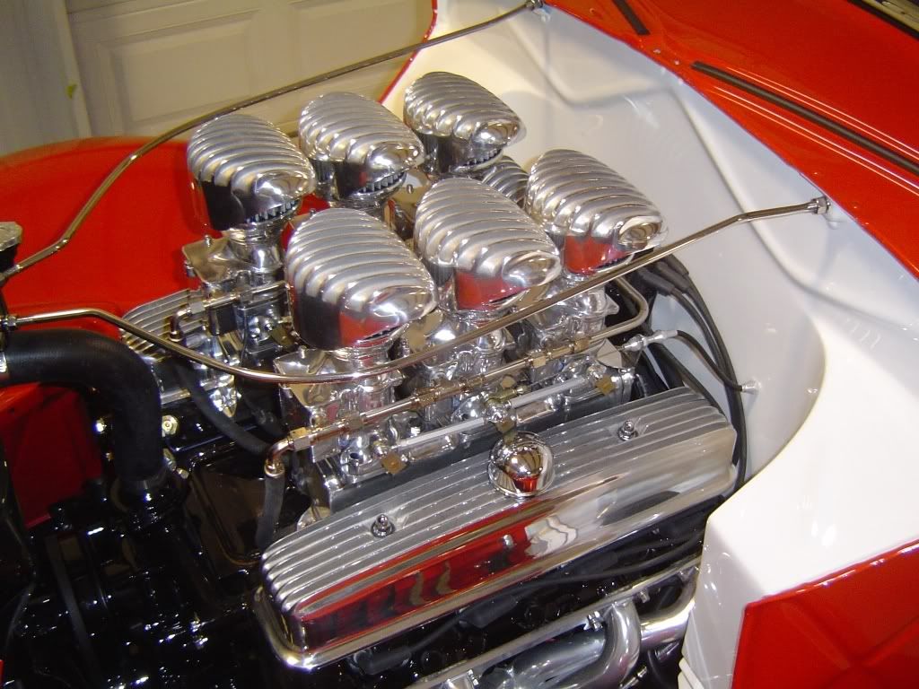

Rellim51 03-18-2008 07:11 PM
Not turbocharged but it is pretty strong. The carbs are actually throttle bodies with 2 injectors hidden in each one. It's controlled by a FAST XFI computer.
http://i205.photobucket.com/albums/b...51/6145494.jpg

That's a great looking engine. Looks like the intake might be from EELCO. They have some pretty trick parts, but NOBODY make any Aluminum Head at ALL!
It's strange to me that Edelbrock would make heads for the 409 that they made 2 years. (I believe there was 50,000 or so, and not build heads for the Nailhead.
