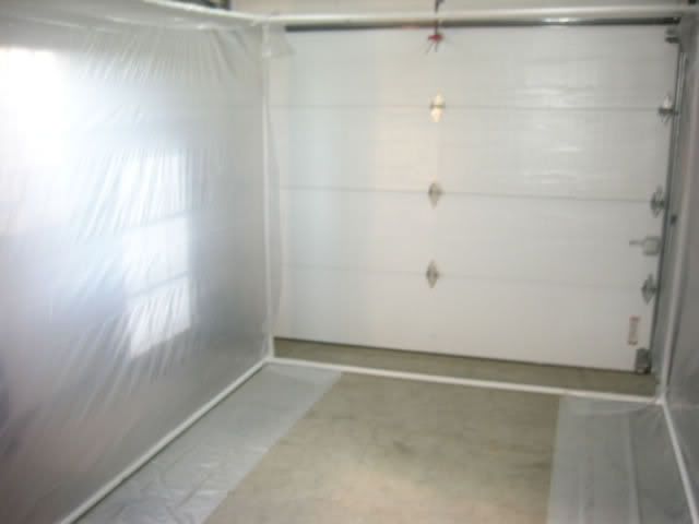

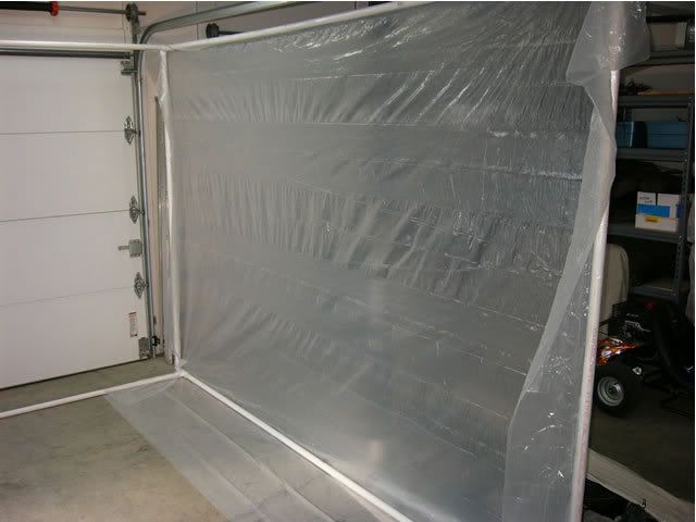

How to build a paint booth in your garage without pissing off your wife!
Well, I lied about pissing off your wife. My wife is still upset that she “did not get her garage back” when I sent my car to a local body shop. Now, when she complains about me spending time in the garage, I remind her that the sooner I get done the sooner she can get the garage back!

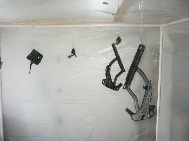

I spent about $75 dollars in materials and it took about 4 hours to build. I am sandblasting and painting all the small parts instead of paying someone else to do it.
I have used the paint booth several times over the past two months and it works great! It keeps the fumes from getting into the house and I don’t have to worry about dust, bugs, dirt getting and the kids touching the wet paint.
Materials:
• 4 x Roll of clear plastic 8x10'
• 2 x cans of aerosol spray adhesive
• 8 x 8' x 1" PVC Pipe
• 4 x 10' x 1" PVC Pipe
• 8 x elbows 1"
• 8 x T connectors 1"
• 1 x can pipe dope
Below are some pictures:
http://i254.photobucket.com/albums/h...o/P1030477.jpg
http://i254.photobucket.com/albums/h...o/P1030478.jpg
http://i254.photobucket.com/albums/h...o/P1030501.jpg

Yeah, your right…I used the aerosol adhesive to glue the plastic to the PVC pipe. My original plan was to use a bunch of tape, but my father suggested that I use the spray adhesive. It worked well and sealed everything tight.
I believe I used 6 mil plastic. Its pretty thin, but effective. I would probably use something thicker if it was going to be outside
Good luck!
Rhino 06-10-2008 02:24 PM
I'm in the process of doing the exact same thing now, other than I built mine 16 foot long to encompass my entire car and pinned a few of the joints to allow me to tear it down as needed. Mine is for sandblasting so I'm not nearly as concerned with air tightness as I was simply recovering the media.
How sturdy is your structure? Mine seems to sag much more than yours does, even though our horizontal spans are similar.
markd 06-10-2008 06:47 PM
Mine structure is sturdy, but it’s only 8’ long. I like your idea of pinning the joints…I was not thinking that far ahead!

i did the same thing about 4 or 5 years ago but i just used 2x4 studs. i mounted the squirrel cage type fans in the front top corners of the the booth and a small one in the back bottom.. you want the pressure to be slightly positive so you dont suck dirt in! i used regular home a/c filters to filter the incoming air:thumbsup: i was 20 and it worked like a charm.. i got nicer jobs out of that booth that i do with our 50k booth at work... haha

read my post above.. and its importants to use a fan that doesnt have the motor exposed.. if you use a regular box fan or something you risk the paint fumes being ingnited by the fan motor.. :willy:
