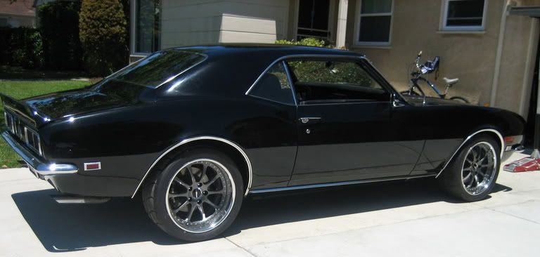

eville 03-26-2008 03:30 PM
Just wait and see once you have your motor in.
I have the hotchkis springs in my car with AFX spindles (.75 drop). I'll need to cut my coils a bit to get the car a little lower.
When I put mine in, I did not need a spring compressor.
http://i34.photobucket.com/albums/d1...5/IMG_1092.jpg
