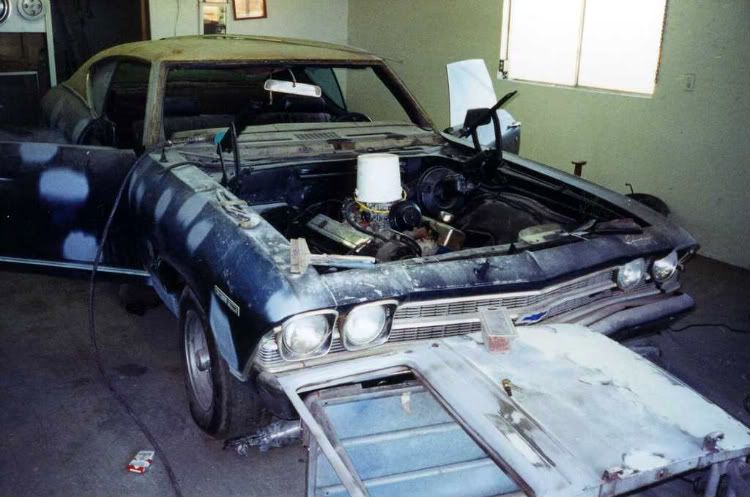

I thought I would start a project thread on my car. It is nothing over the top like some of the killer cars here, but rather something that I am building with out credit card debt or a 2nd mortgage and within in my means :) . And I will say this board has motivated me in many ways. In addition caused me to redo many parts that I did not research before buying. Here is a pic of the POS when I bought it.
http://i186.photobucket.com/albums/x...erf/img068.jpg

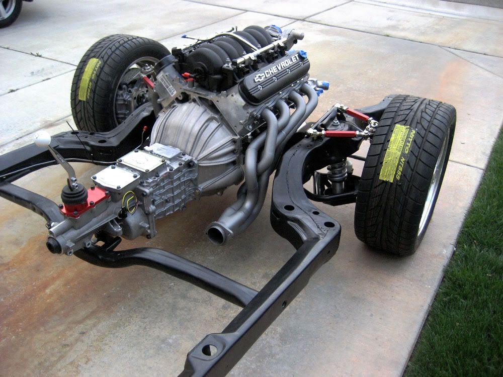

The engine is a LS3 with L76 intake. I got the engine late last year from gmcopo. It is basically a service/warranty 08 LS3 long block. I plan to run Vette acc. drive for now. I will install a Vintage air in the car for later. I am using ATS LSX pan and mounts. Headers are Edelbrock 1-3/4" stepped to
1-7/8". Harness will be Speartech with DBW and John suggested I use an LS2 MAF. Radiator Ron Davis and was a little more than twice what I paid for this whole POS car:lol:
http://i186.photobucket.com/albums/x...harness750.jpg
http://i186.photobucket.com/albums/x...rf/rad2750.jpg
