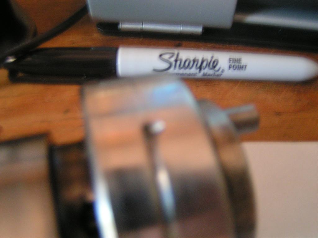

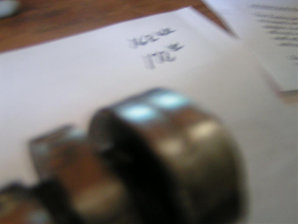

what happened to this cam,and is it terminal?
70TWO NOVA 06-05-2008 01:09 PM
pic is kinda blurry, but it looks like some debris got in beteween the cam and bearing.
deuce_454 06-05-2008 03:28 PM
i can only make out that it got photografed... and on the thumbnail it looks like it got gouged bt some debris... if thats the case.. grind down whar ever sticke out and reinstall with a fresh bearing and you should be fine.... turning a groove in it on a lathe will also do the trick

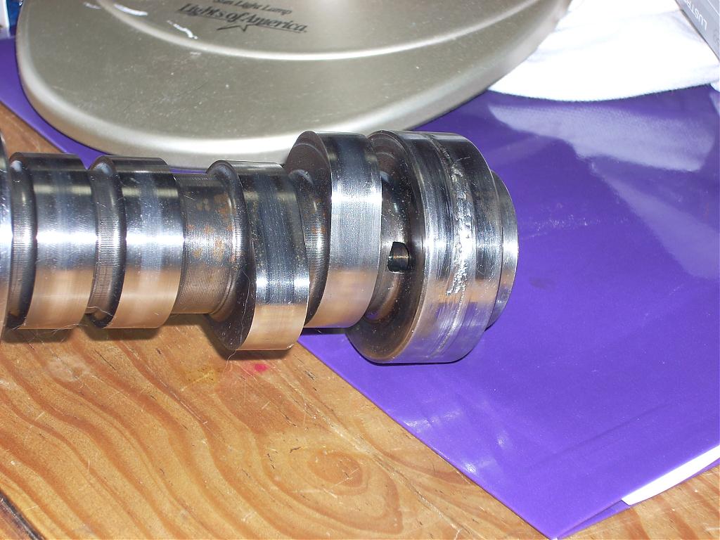

i changed camera and edited perhaps this will help, is the cam salvageable and if so how?? or maybe who is a better question, thanks guys
JUSTANOVA 06-05-2008 07:55 PM
I wonder if the cam manufacturer can "fix" the journal like they do for wiped out lobes.
deuce_454 06-09-2008 12:12 AM
that is fixable... any engineshop can grind that in the crank grinder.. its just a question of removing whatever "sticks up" all the holes will just act as oilpockets...
im sure that whatever shop accepts the job will tell you that they wont take any responsibillty! but it is a quick fix
and remember to replace the cam bearings ;-) but that should be a no brainer
