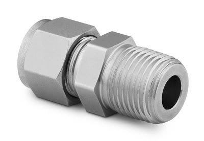

I will put together a list and let you know. I can see that using the 20' lengths of tubing would be nice for those straight runs. Do you use tubing cutters to cut the stainless tubing? I am still figuring out what i will need but i think most of my fittings are just male connects. One side thread and the other is a compression fitting. I will need a few that are a 90deg instead of straight ones. Here is a pic http://i212.photobucket.com/albums/c...lokfitting.jpg Do you have an idea on what this fitting would cost? My air lines are only 1/4". Thanks Rodger!

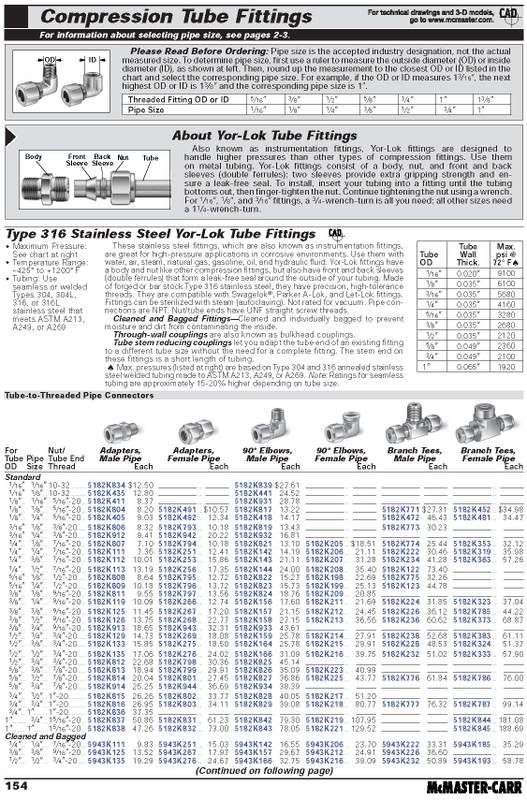

dave96dcm 06-11-2008 07:16 AM
Go to mcmaster.com and search for Yor-Lok fittings. A example of the fitting that you are looking for is part number 5943K111 it is $9.83
ccracin 06-11-2008 09:17 AM
That's good advice Josh.
