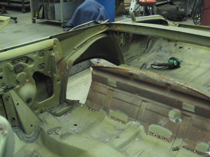

I started this job for a customer it is a 64 Skylark about a month ago. Going with the Pro-Touring theme it will get a 455 with a 5-Speed and a 9" Ford. Ride height will be 6" The car is really nice for a ragtop the floor is solid , but it will get cut up.

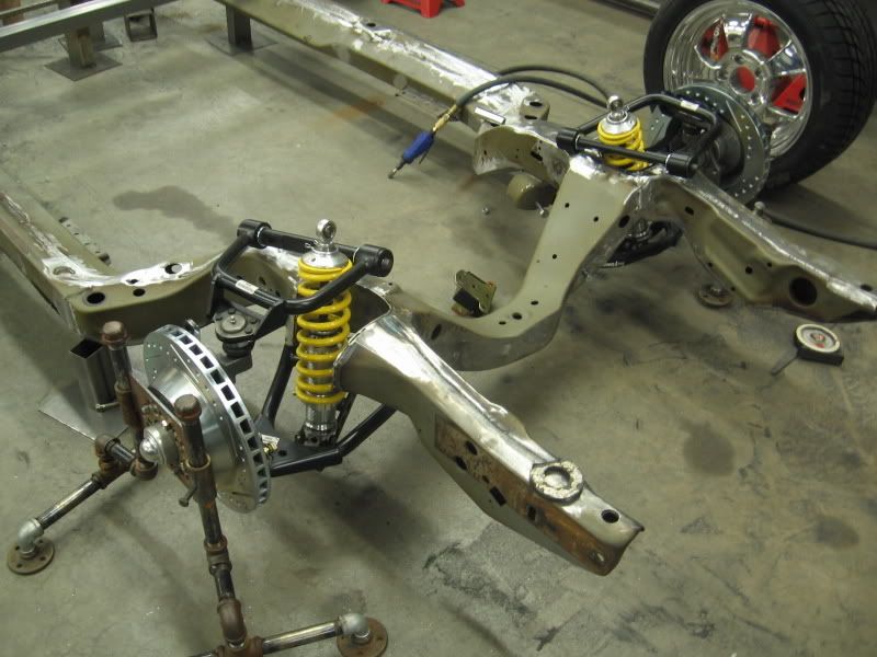

The coilovers are from AFCO with Air Ride Strong Arms.
http://i100.photobucket.com/albums/m...U/IMG_2323.jpg
http://i100.photobucket.com/albums/m...U/IMG_2315.jpg

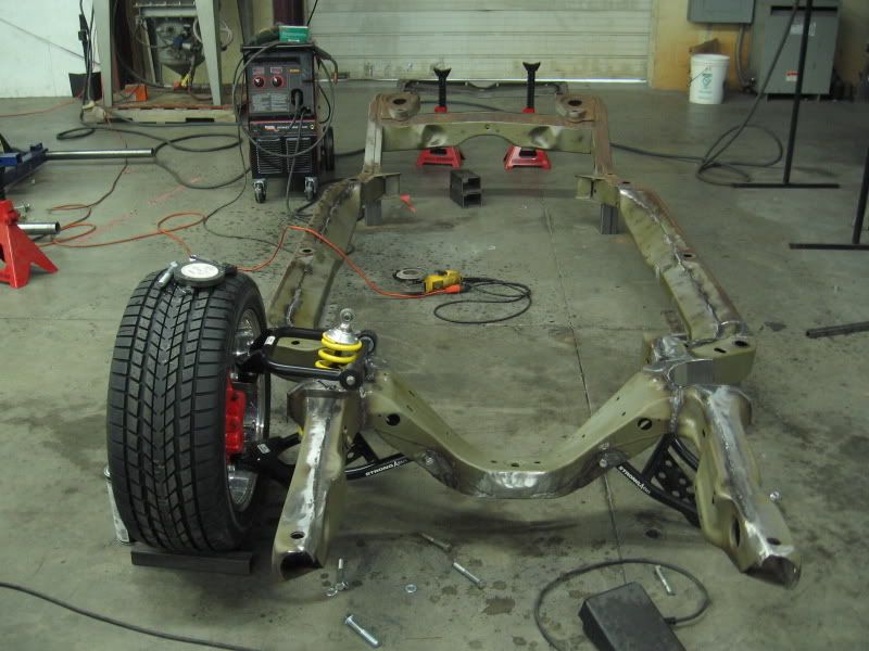

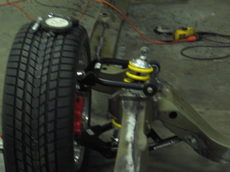

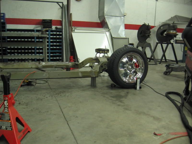

Here are some more pictures of the front end. I don't want to make weld everything up just yet. The ride height is 6" so I want to make sure that the tires clear.
http://i100.photobucket.com/albums/m...U/IMG_2443.jpg
http://i100.photobucket.com/albums/m...U/IMG_2442.jpg
http://i100.photobucket.com/albums/m...U/IMG_2437.jpg

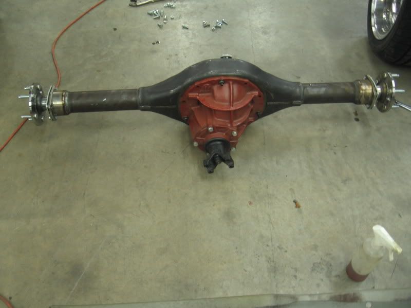

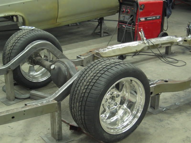

The rear is a 9" Ford The coilovers are AFCO The springs will be black.
http://i100.photobucket.com/albums/m...U/IMG_2440.jpg
LUCKINFOU 07-20-2008 03:43 PM

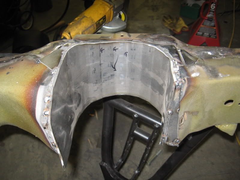

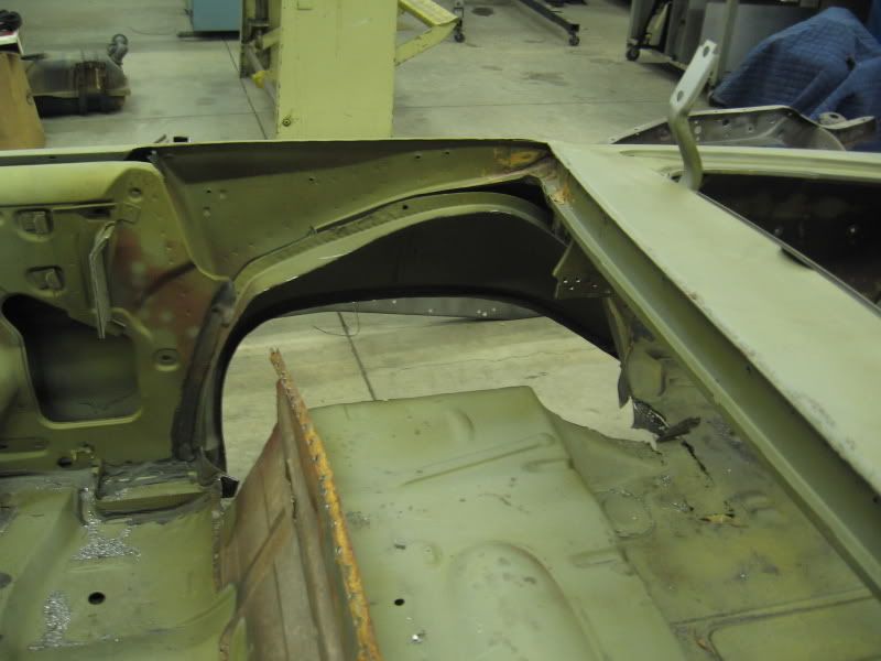

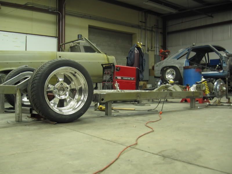

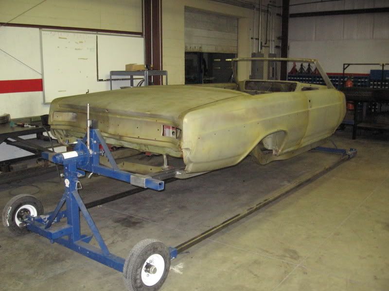

We put the body on so we could center up the wheels. The 9" is from Moser I didn't blow the car apart so I have no trailing arms not to mention I we have to do major chassis work in the rear.This is ride height coil overs all the way around.
http://i100.photobucket.com/albums/m...U/IMG_2444.jpg
The plan is a mini tub we have to be careful not to go to crazy and mess up the ragtop.
http://i100.photobucket.com/albums/m...U/IMG_2446.jpg
http://i100.photobucket.com/albums/m...U/IMG_2445.jpg

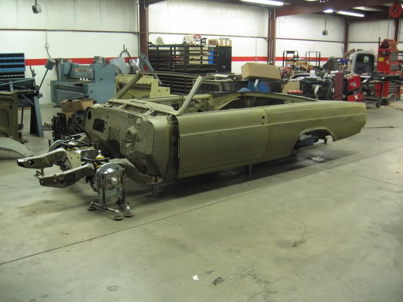

LUCKINFOU 07-20-2008 03:47 PM

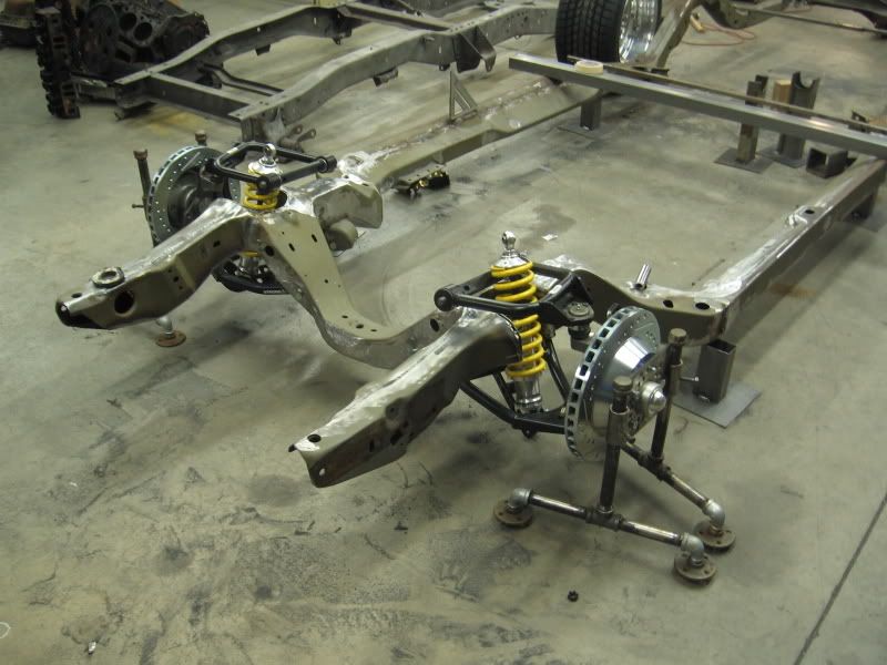

Here are some more pictures for you guys. We put the body on so we could square everything up. The rear suspension will be a 4-Bar with coil overs I had to many pictures so I split in half.
http://i100.photobucket.com/albums/m...U/IMG_2470.jpg
http://i100.photobucket.com/albums/m...U/IMG_2471.jpg

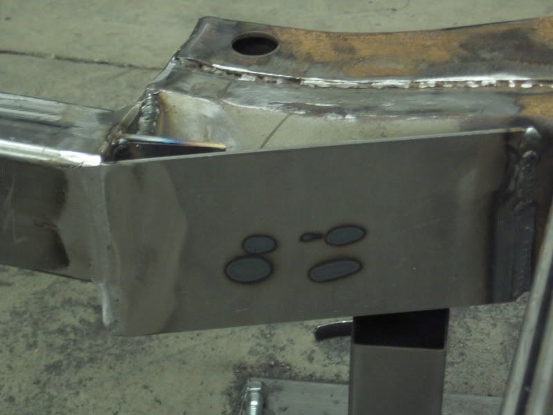

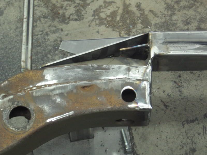

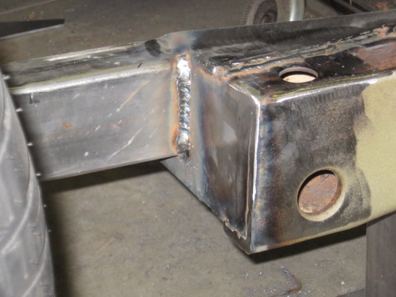

You can see here the frame was cut and a new kick up is being put in a piece of 1/8" plate was laid in to hold the new and old rail together. The gussets are 1/4" there will be plate on both sides. Then it will be ground smooth.
http://i100.photobucket.com/albums/m...U/IMG_2473.jpg
http://i100.photobucket.com/albums/m...U/IMG_2477.jpg
