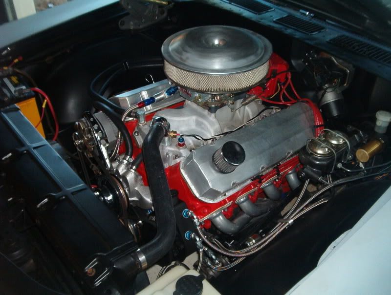

SS454 09-18-2008 05:30 PM
I promised a picture of what I had to do to get my Hydraboost to work. I ran a seperate line to the power steering reservoir and the system works flawlessly. I also went ahead and welded up the stock return line on the reservoir and added another for the steering right below the brake return line so they would match.
