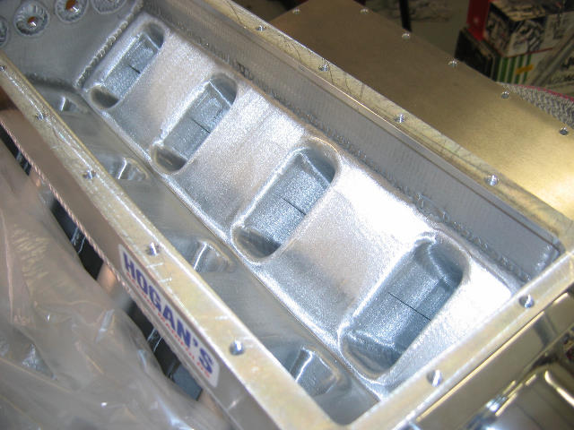

My guess is the PMC unit will make more low and mid-range torque due to the runners extended up into the plenum with a bell top making it an IR setup with a plenum over it. It would be a cool test though.

So the Hogan's runners stop at the plenum? I realize that it is a huge leap for someone to send me their $2000+ intakes, but I would hope that enough people here either know me or have dealt with me to know I am a straight up guy.

yes, Hogans are like this:
http://www.camcojb.com/temp/mal081.jpg
Precision Metalcraft is like this:
http://www.camcojb.com/temp/malitude 357.jpg

that is true, but I'm still thinking with that extended runner length of the PMC design that it will give a very broad power range and very good low to mid range torque. It sure does with an IR setup, and that's pretty much what this is, with a plenum over the top.
I of course have no facts to back this up; this just comes from running an IR setup and the changes it made over a single 4 barrel throttle body and single plane intake, and looking at the design of my PMC intake, just my personal opinion. I'd love to see someone do some back to back engine dynoing of stock vs the PMC.
