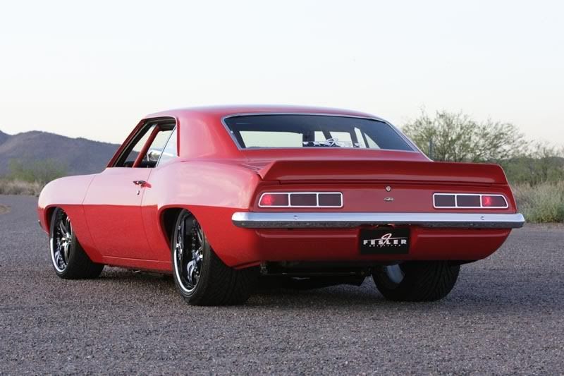

We run 275 front and 345 rear on the Carmaros we build. A little C is all it needs to clear and when you are at driving hieght it clears fender with no problems. You can run a small tire but the large tire looks much better.
http://i269.photobucket.com/albums/j...co/Img0149.jpg
http://i269.photobucket.com/albums/j...ro/Img0011.jpg
