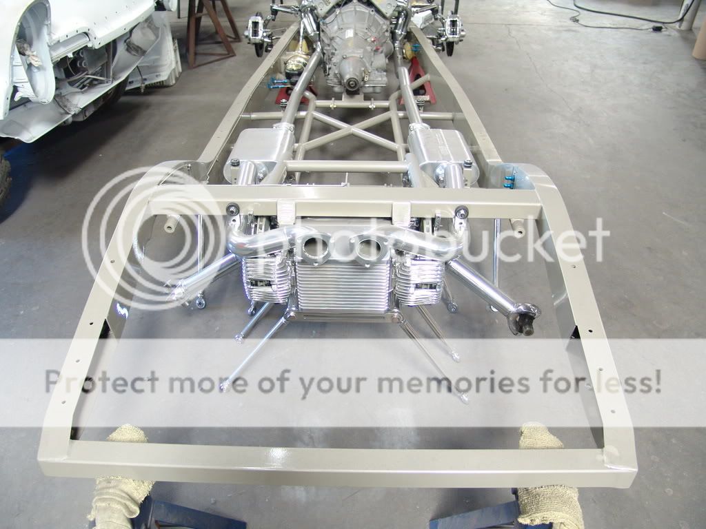

Scotts Hotrods Chassis

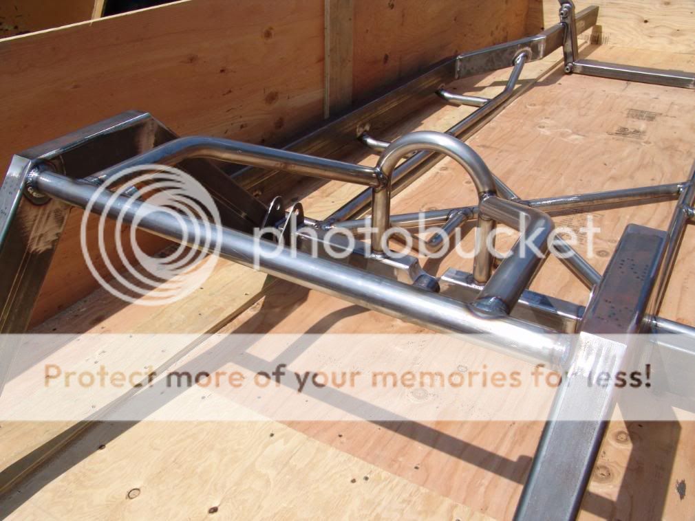

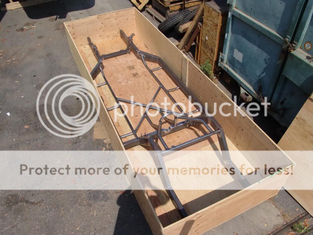

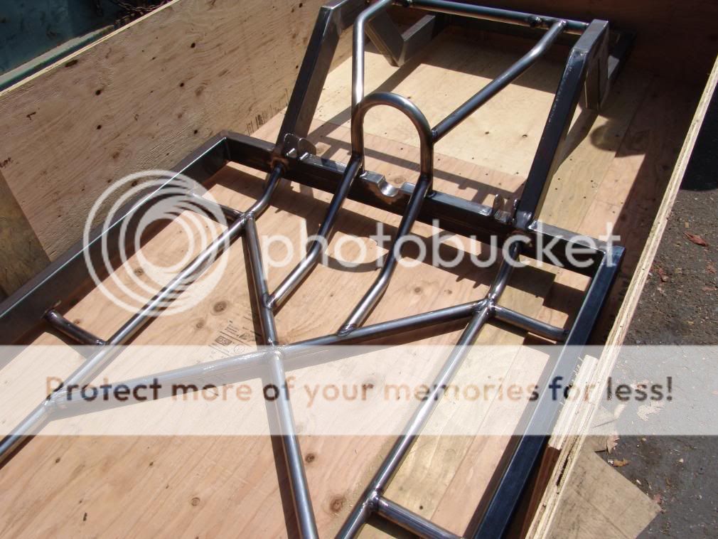

As a new sponsor here I just thought I'd post up one of our chassis's for you guys to see. without going into full detail specs on our Mustang chassis, it rides and handles fantastic as tested by our project cars, and does not require removing 3-4 inches out of the floor pan. This one sits under a 65 Mustang now.
http://i353.photobucket.com/albums/r...g/DSC05208.jpg
http://i353.photobucket.com/albums/r...g/DSC05215.jpg
http://i353.photobucket.com/albums/r...g/DSC05218.jpg
http://i353.photobucket.com/albums/r...g/DSC05219.jpg

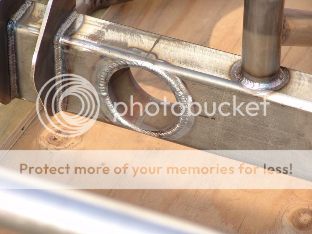

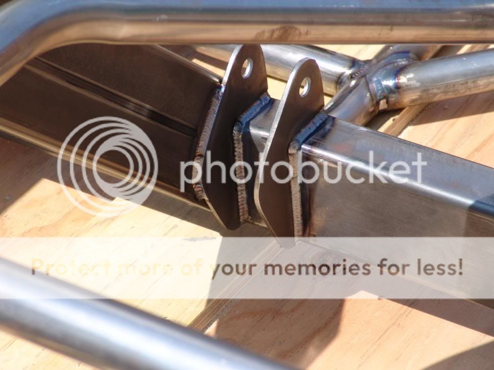

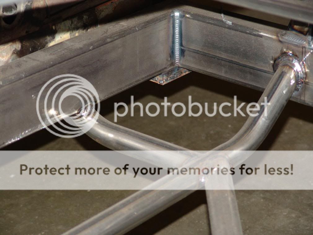

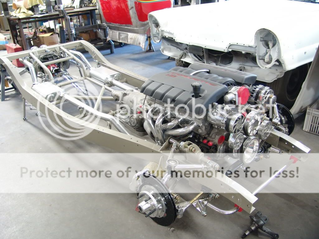

As all of our products are, this chassis is 100% TIG welded and comes with our iron clad guarantee.
http://i353.photobucket.com/albums/r...g/DSC05222.jpg
http://i353.photobucket.com/albums/r...g/DSC05247.jpg
http://i353.photobucket.com/albums/r...s/DSC05070.jpg

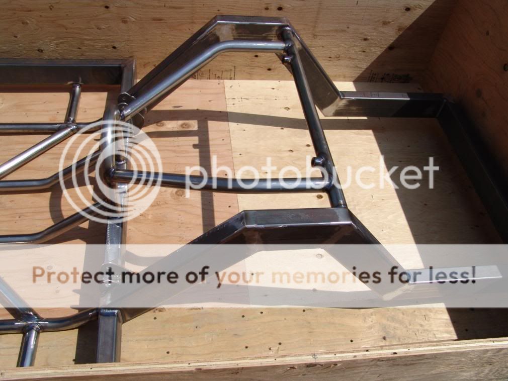

because if this...no lost seat room :D
http://i353.photobucket.com/albums/r...g/DSC05430.jpg

Awesome looking welds.

Thanks:thumbsup:

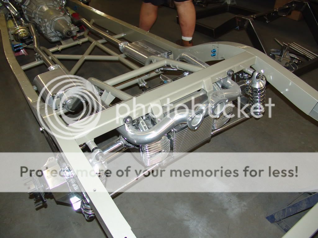

Here's a nice chassis for a pro-touring 37 3 window.
our suspension up front, and a customer supplied Kugel IRS.

Fantastic work !!! And i just wish i could weld like that :bow:
Boulder69 09-11-2008 12:36 PM
Those are some killer welds for sure. Very skilled.
What are the tech specs on the front suspension?

Well, it varies. All of our suspensions are built per spec.
So say for instance you have a 67 Chevelle, or even a 40 Ford. If we don't have basic measurements we will get them from you, but in 99% of the case, we already do. We will design a crossmember first to fit, then we will design a set of a-arms for the correct track, ride height, scrub, etc.
they are all made form 1-1/18x1/4 wall dom tubing and cnc'd in house. All of our front ends are fully adjustable upper and lower with our Billet stainless rod ends. Again, all 100% tig welded and built to spec.
