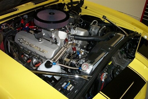

496 BBC dart intake with 14" drop base and stock cowl hood
http://i98.photobucket.com/albums/l2...3/DSC00569.jpg
