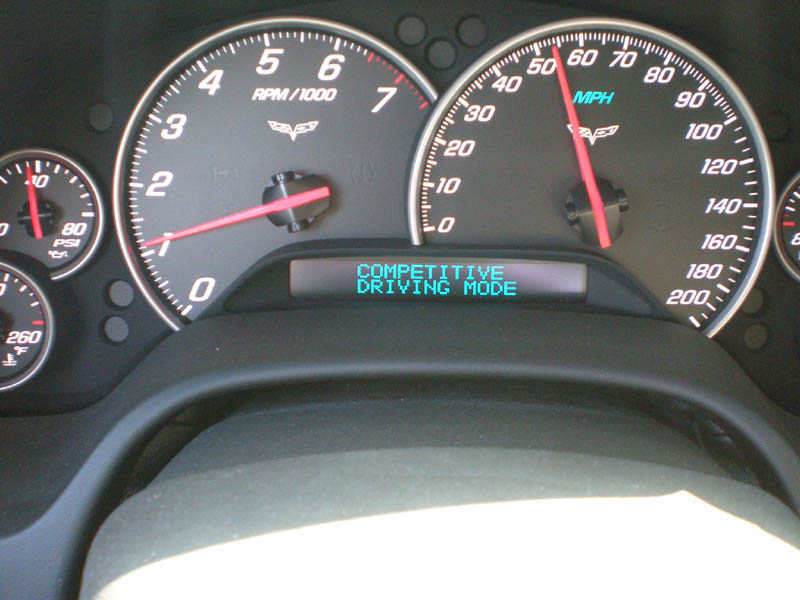

We really enjoyed thrashing this little beast around in "Competive Mode", which relaxes the active handling and suspension I'd guess about 30%

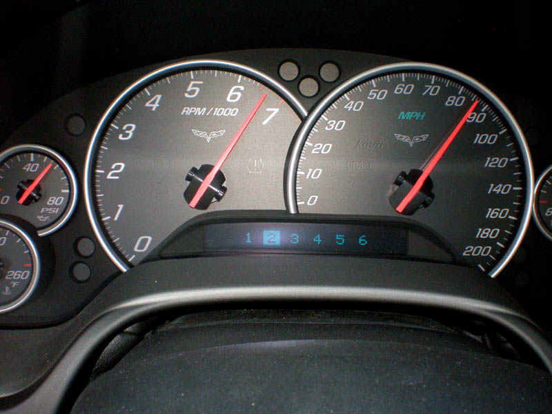

Playing around with the paddle shifter was also fun too! Too high of a rear end gear ratio though in this one, with second gear topping out at over 85 MPH.
30 MPG was definitely impressive though!

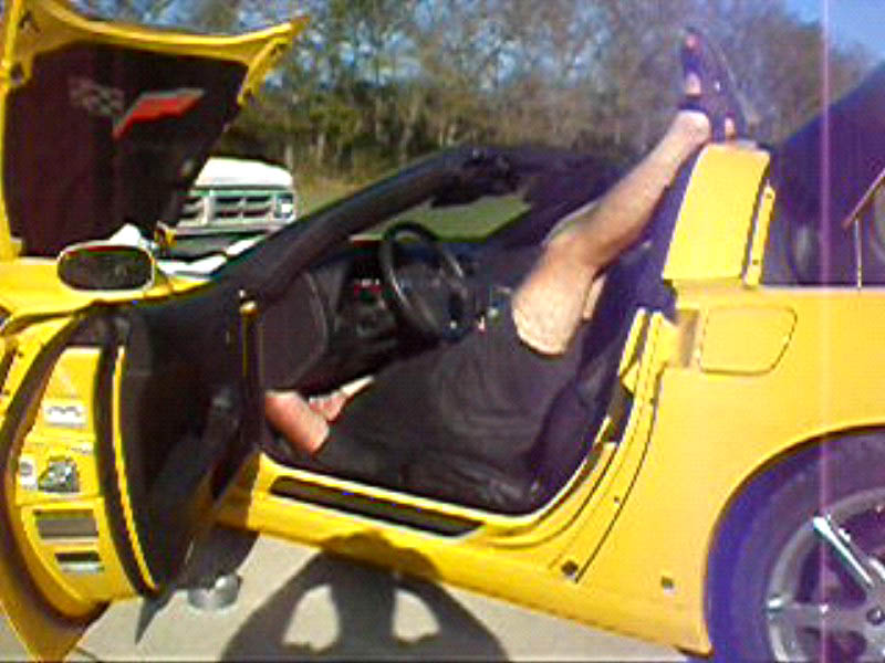

Re-adjusting the brake pedal height was simpler with the targa roof stowed in the back (and left me sore for a few days afterwards!) :lol:

And of course the action shot! :lol:

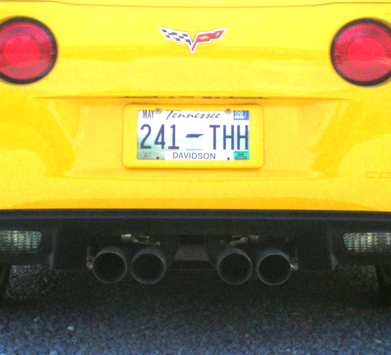

I wish I had taken a better pic of the "dual mode exhaust", as it was really neat to have a car that is quiet as a door mouse when just rollin' down the road, yet really sound off when the loud pedal was applied!
Not the best pic, though you can somewhat see the vacuum pots on top of the center two exhaust tips:
http://www.hydratechbraking.com/images/C6RND8.jpg
When you are just rollin' down the road, all of the exhaust exits the outer most two tips, and the butterflies in the center two tips are closed (sucked shut by the vacuum pots). When you hammer it, the butterflies open up and she really talks to you! Flashlight inspection into the mufflers seemed to show a straight through shot when these butterflies are open. :unibrow: Looks like something I'm going to want to incorporate into our next build!

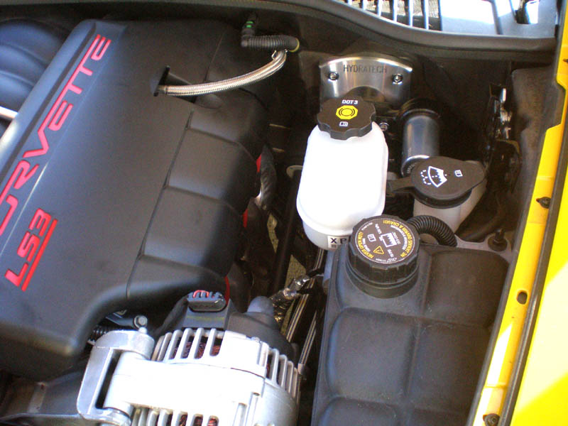

http://www.hydratechbraking.com/images/C6RND4.jpg
that vacuum line with the green clip is for the exhust flaps. if you pull the line from that check valve they will stay open all the time. learned that from a engineer at the corvette plant :thumbsup:
