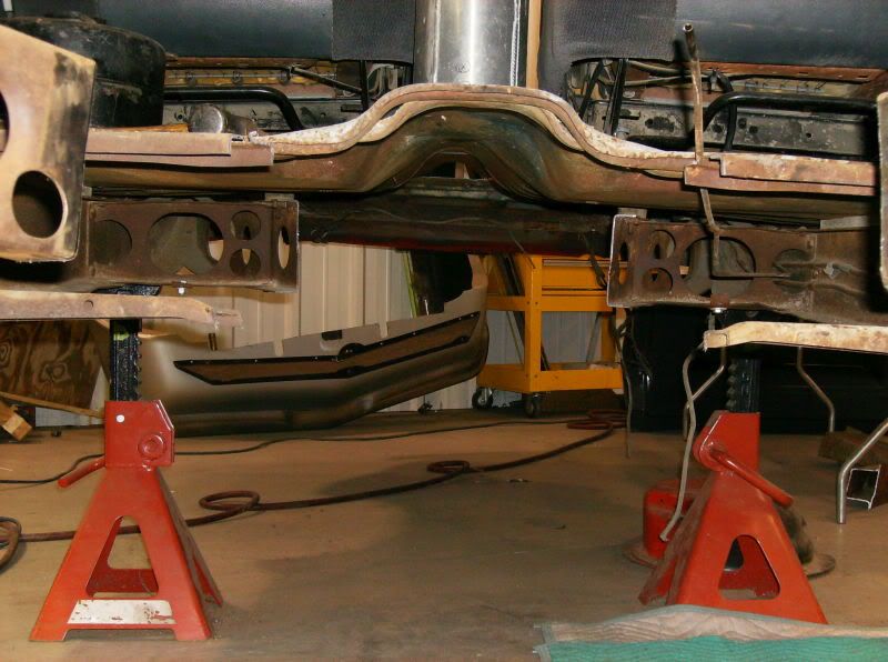

ratty 46 10-24-2008 03:08 PM
After removing & selling off the front & rear suspension, engine, trans & torque tube along with the wheels & tires it was cutting time.
So far I've removed the front & rear suspension X member mounts along with the center part of the X member.
My intention is to install some fab'd C channel to run on each side parallel to the frame back into the remaining X member. I'll be using this as the side mounting point for my front 4 link setup, driveshaft loop, trans mount & possibly an addt'l brace for strenght.
I also scored a Currie built 9" third member with 4:11 gears & a detriot locker.
So...... as soon as I get the "C" channel I'm back in biz & moving forward.
http://i182.photobucket.com/albums/x...icture1433.jpg
http://i182.photobucket.com/albums/x...icture1429.jpg
http://i182.photobucket.com/albums/x...icture1430.jpg
http://i182.photobucket.com/albums/x...icture1431.jpg
Ratty 46
