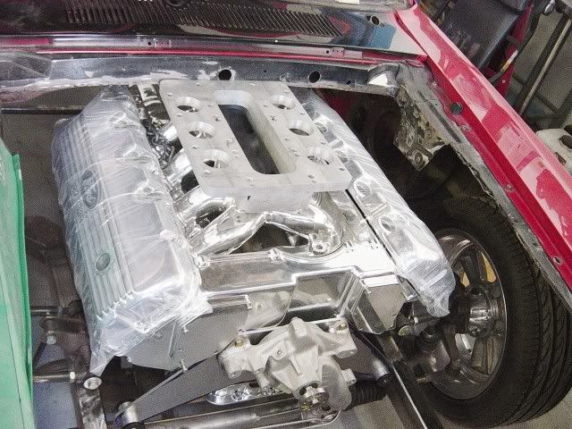

Psmfab would like to introduce one of it's on going projects,
a 69 super cobra jet Mustang. It started out as a cobra jet, but upon further investigation we found it wasn't a matching engine/block. The only thing that matched was the cylinder heads. So by request of the owner we went full custom with the car. Here is a list of parts/modifications planned;

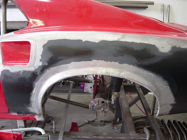

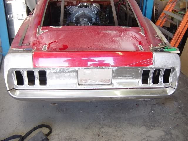

We have most of the chassis and sheet metal work done, still mocking up a
lot of things.
Here are a few samples of the car so far, i will have a link to a photo album with dozens of photos soon.
http://i271.photobucket.com/albums/j...g/DSC06882.jpg
http://i271.photobucket.com/albums/j...mustang091.jpg
http://i271.photobucket.com/albums/j...mustang145.jpg
More to come, i will post some post some shots of the car on the ground soon, still waiting on the wheels(owner still deciding)

Holy crap! where did the SOHC cammer come from?
PsmFab 11-05-2008 05:34 PM
hi we got the motor from david dove ent. in ohio. they recast all the parts and machine them , it took a long time to get the motor, about a year! and cost around 32 K. that doesnt include all the small parts either. also everything needs remachining and blueprinting.
