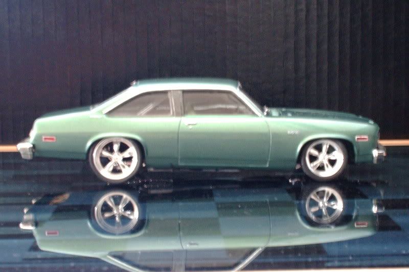

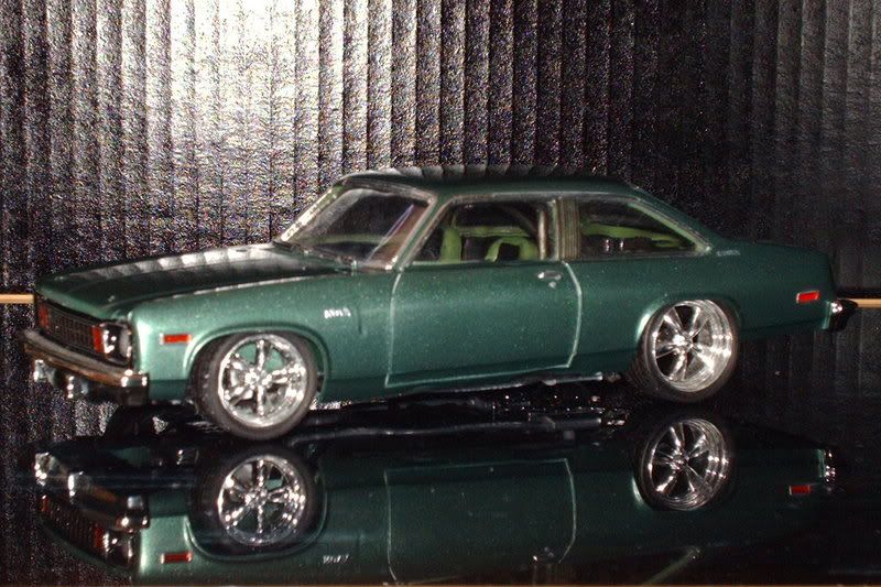

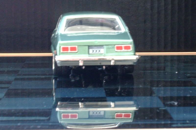

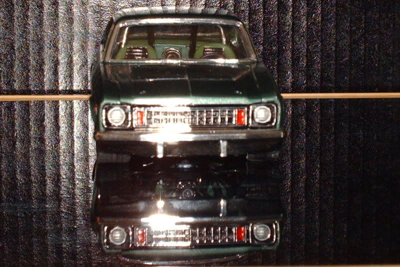

here's a pic of a model i built for my dad. i'm currently building one for myself.i'll post pics of it when it's completed.
http://i140.photobucket.com/albums/r...r/HPIM1638.jpg
http://i140.photobucket.com/albums/r...r/HPIM1635.jpg
http://i140.photobucket.com/albums/r...r/HPIM1636.jpg
http://i140.photobucket.com/albums/r...r/HPIM1640.jpg
