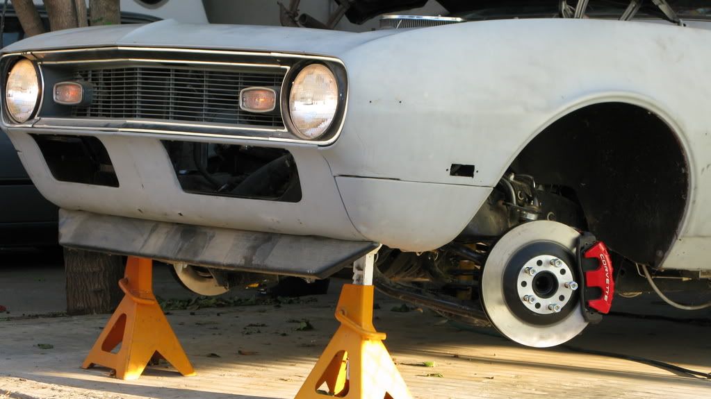

sik68 11-14-2008 09:00 AM
I might be of some help...my ongoing buildup has a bunch of information from installing the KORE3 kit to my 68 camaro with 17" wheels and ATS spindles.
Hope it helps!
:thumbsup:
http://i207.photobucket.com/albums/b...o/IMG_0722.jpg
LowchevyII 11-14-2008 07:22 PM
sik68, thank you so much. that picture in itself helps not to mention your link. i appreciate the help! im really excited to get some decent brakes on this car.
